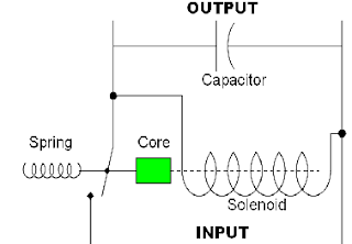

Original ones were electro mechanical.

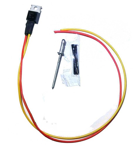

If you still have a dynamo it should be easy to switch to the battery negative earth norm. You then have a greater range of solid state instrument regulators. I used this one on a Land Rover.

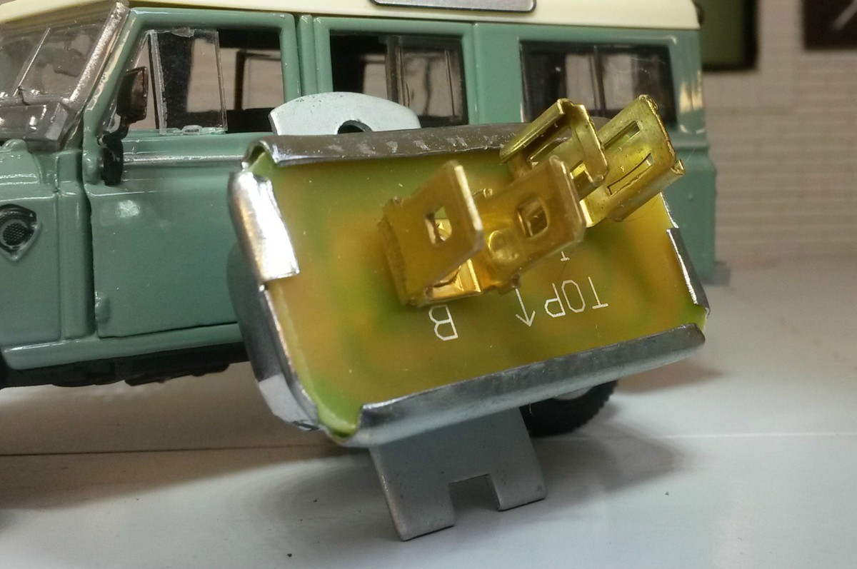

Note the one you originally ordered appeared to be electro mechanical, likely as below.
