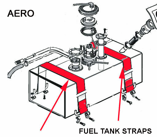

P.S. On convenient occasions, check the strap (S) holding the tank in place. If you don't have them on your car, add them. Cheap insurance according to the crash tests.

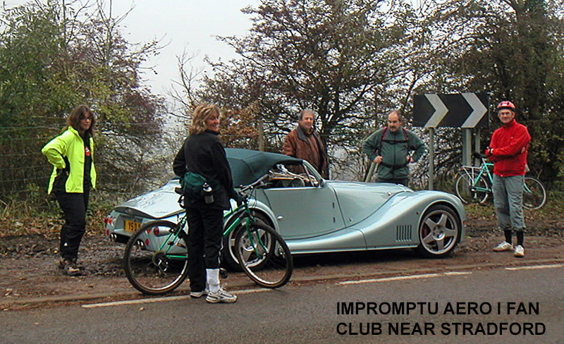

Just one question about your photo as the side of the road, are the crowd admiring the car or the lady with the bike?
Probably wondering how she had a "one sock in, one sock out" wardrobe malfunction crazy2

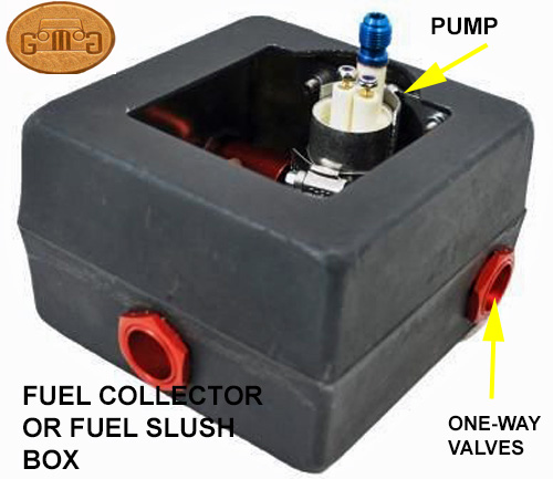

You are wise to fill up when you do. Internal pumps have two advantages.
A. They are comparatively VERY cheap and combined with a fuel level sender they save manufacturing man-hours.
B. Unless the fuel level is allowed to drop too much, they are constantly cooled by being immersed in fuel.
However, they are very delicate when NOt fully immersed. They can fatally overheat. Levels can change almost immediately by going up a hill or an aggressive curve. They are best used with a fuel collector, (aka a slosh box) which Morgans don't use AFAIK. Such collector thingies are a box (below) fed through one-way valves and always used by savvy race preparers. One places the fuel pickup or pump inside the box. Otherwise one must depend on internal baffling, which is unknown since the MMC abandoned the old tanks or by using foam. Foam is great, but makes roadside pump replacement unfun. (yuk!) I finally became annoyed and, with the assistance of Peter (Mulberry) designed my own tank which uses an external pump, which needs a precise setup. Luddite first helped me with that way back when. Canada, an economy dealing constantly with machinery repair, has more relaxed rules and skills for such creativity than other countries. BTW, foam filled tanks are as deadly as any aluminum tanks. For some reason, the UK never got into the world habit of using foam-filled deformable bladders. For that reason I shun ALL aftermarket tanks unless they are made of high quality stainless steel, which dents rather than tears. Aluminum also has a habit of very suddenly melting at relatively low temps..and worse.
laugh2 laugh2 The lady you refer to was a member of the admiring crowd, my wife is took the picture. I am the scruffy fellow in the middle. They certainly weren't admiring me!
Curious. Does your Aero have the fuel tank straps I have shown above? They were added after the crash tests results. I have learned to like them more than the industry custom of bolting down fuel tanks, without cushioning, to chassis. Though not at first. However, our dearly remembered Bill Fink, an American Morgan dealer and a close confident of Maurice Owen and Peter Morgan, explained that they worked better than the accepted custom, of bolting especially with Morgans.
Hi GMG, I can't say that I have checked whether straps are present, as I've not had cause to remove the trim panel, but perhaps I should
