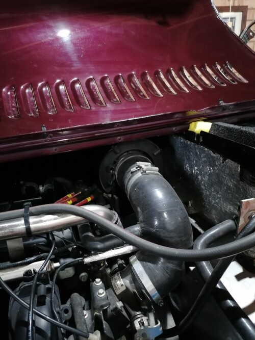

Originally Posted by Mark+4
Hadn't thought of discarding the Intake Box but have seen another thread where someone has fitted the filter just in front of the throttle body on the left (cooler) side of the engine bay.
Like this maybe... smile
Roger
Mark+4 #793301 04/01/24 07:50 AM
Posts: 8,660
Likes: 408
Posts: 8,660
Likes: 408
I can see the logic Rog and Dave of having your inlet filter so placed. The location if I remember correctly is a relative high pressure area once on the move at reasonable speed, as air through cowl hits the upper bulkhead. My only concern would be it's temperature. It would be interesting on a 4 cylinder car to compare IAT with your intake arrangement versus the standard air box fitted with similar minimal restriction filter element, fed by large bore hose with its inlet located above from radiator.

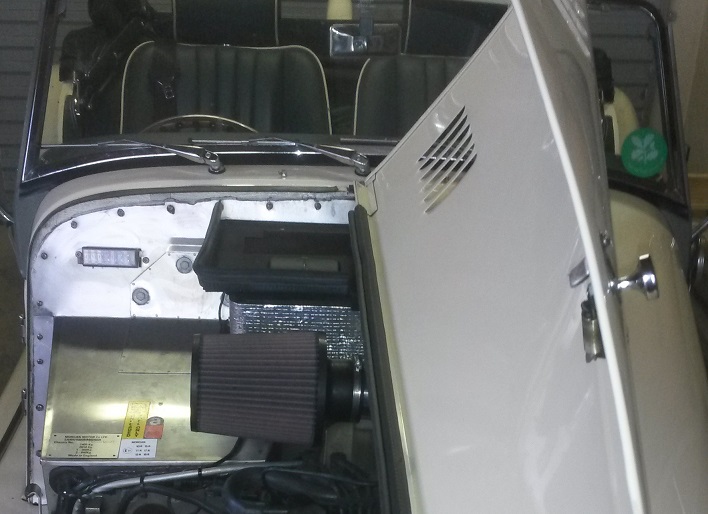

I can confirm that placing an open K&N filter close to the windscreen gave the best results with my 4/4. But I am back to normal currently. It is a 10 minute job to swap the filters when keeping the MAF sensor and using a second one.

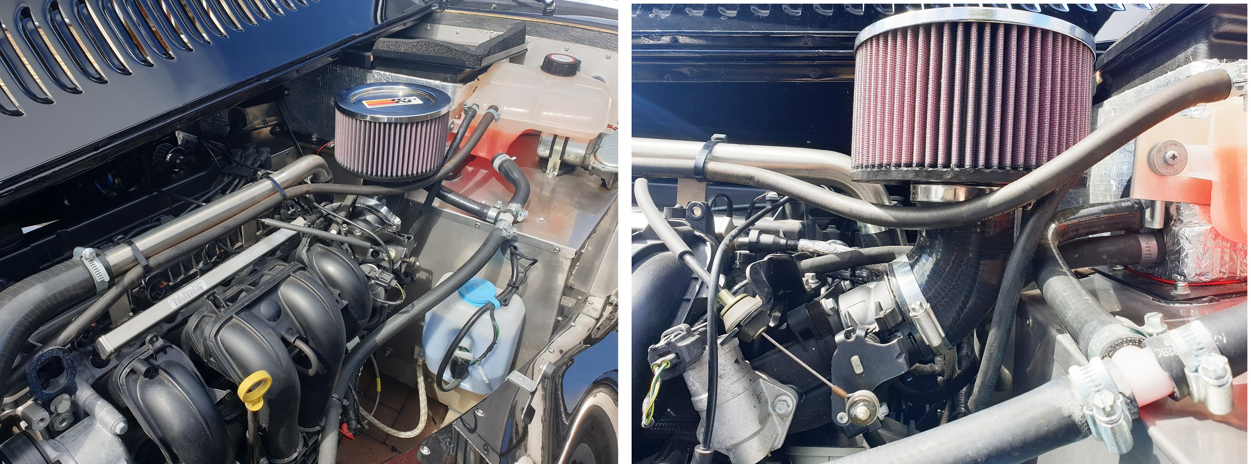

This is my setup Duratec +4

Heinz #793319 04/01/24 12:32 PM
Posts: 1,703
Likes: 35
Rog Offline
Posts: 1,703
Likes: 35
Nice setup Keith, sucking air from the side louvers thumbs
And interstingly whilst the thermal pic of my previous car shows the filter temp maybe a couple of degs over ambient, that car was a little short on louvers....
Like it thumbs
