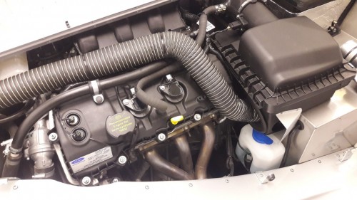

This is my solution on the Roadster, although the cold air ram pipe is a little undersized due to space above the engine, it collects from a nice big flared inlet so when on the move the flow is good, immediately after testing the fan hardly ever cut in
Cowl scoop
The airbox is lined with heat reflective foil as potentially a black plastic box will soak up engine bay heat & bleed this into the incoming air
I didn't seal off the bottom of the airbox as Richard did, but it's on the winter list, as is a bigger side louvre scoop as per the original S1 Roadsters

[quote=CooperMan]This is my solution on the Roadster, although the cold air ram pipe is a little undersized due to space above the engine, it collects from a nice big flared inlet so when on the move the flow is good, immediately after testing the fan hardly ever cut in
Cowl scoop
Hi Jon, where did you source the cowl scoop? or is is home made?

Evening Mark, hope all's well in SY
It was chosen from one of these to suit the gap https://revotec.com/product-category/intakeducts/intake-ducts/
I had to mod it a little by cutting off the flange, my tip is if you warm up with a hot air gun you can modify the shape
Cowl scoop
That looks neat and well thought out Jon. But I can’t believe you Roadster folk still want more….
