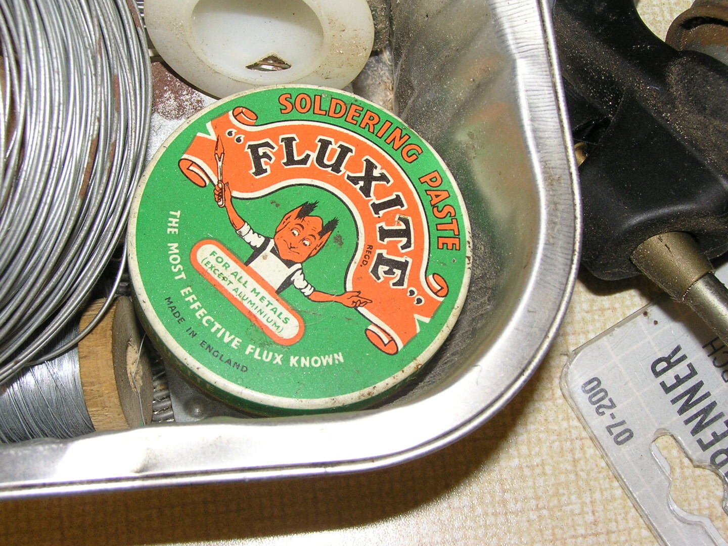

I have a really old tin of Fluxite, and still use it sometimes thumbs

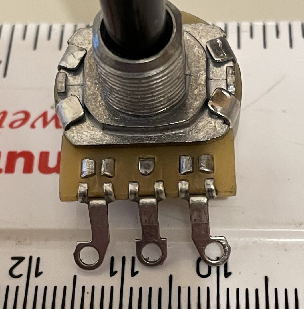

These are the terminals I have to connect.
I'm almost certain they have to be soldered. Scale below in mm.

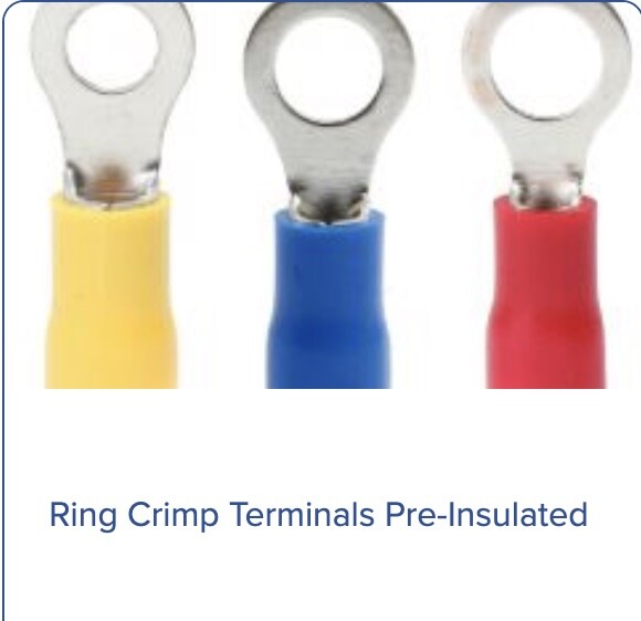

As an alternate to soldering you could use this crimp rouind head connectors and then connect the two with a small nut/bolt/washer
This might be more convenient (but possibly less reliable) than soldering if you want the unit to be easily removable.
