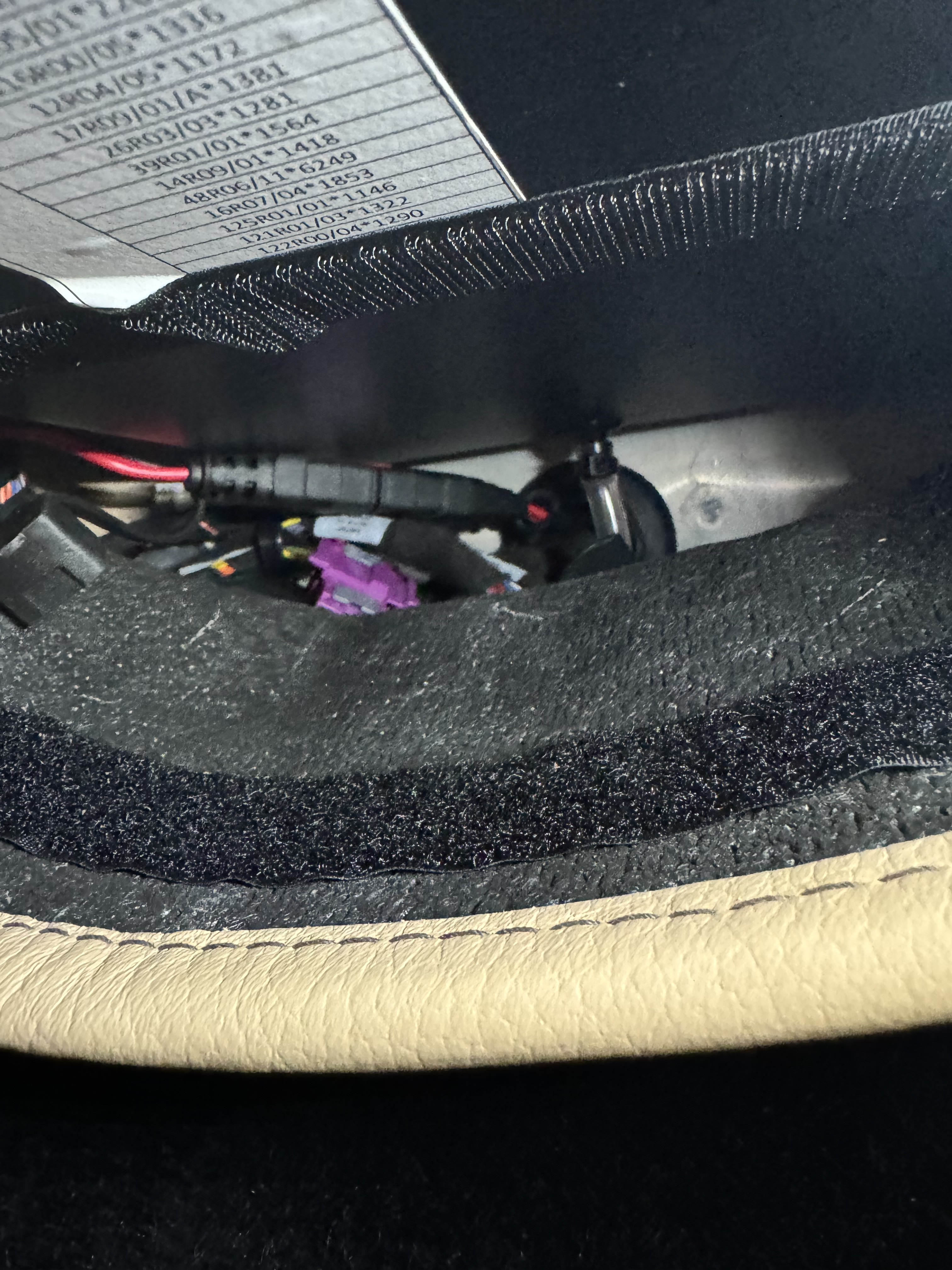

Hi i fitted a lead from the battery into the passenger footwell where i can easily plug in the battery conditioner. There is a nice space behind the carpet for stowing the excess wire and i fed the wire through an existing grommet at the front / side of the footwell. Works well. No bonnet opening and extension permanently connected.

That’s great and sounds just what I’m after… I just can’t find an easy access point into the footwell from the battery 😢
Joined: Jul 2023
Posts: 25
Joined: Jul 2023
Posts: 25
Note to self… look further back in the footwell and not where the glove stow area is 🤦‍♂️🤣👍

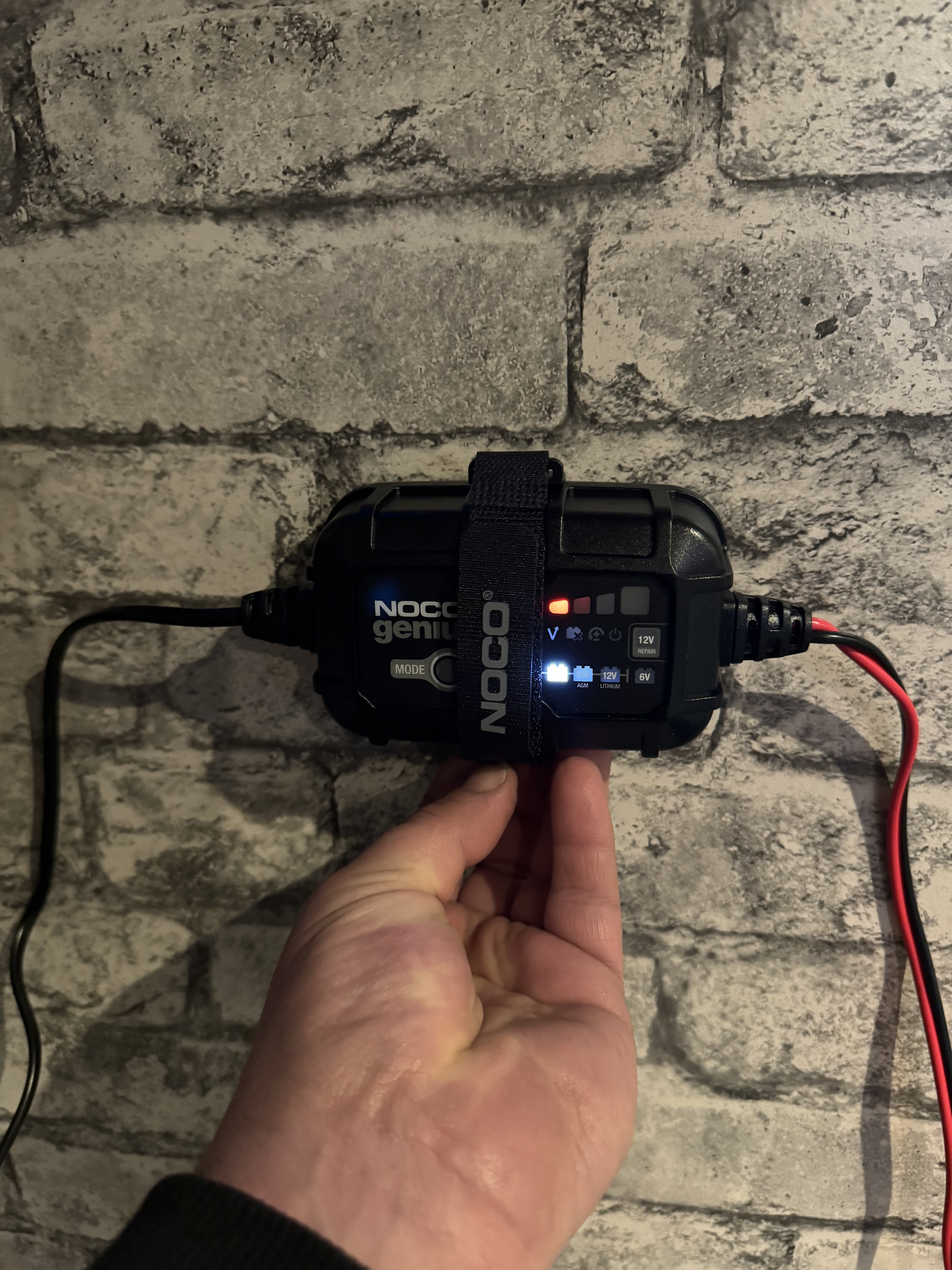

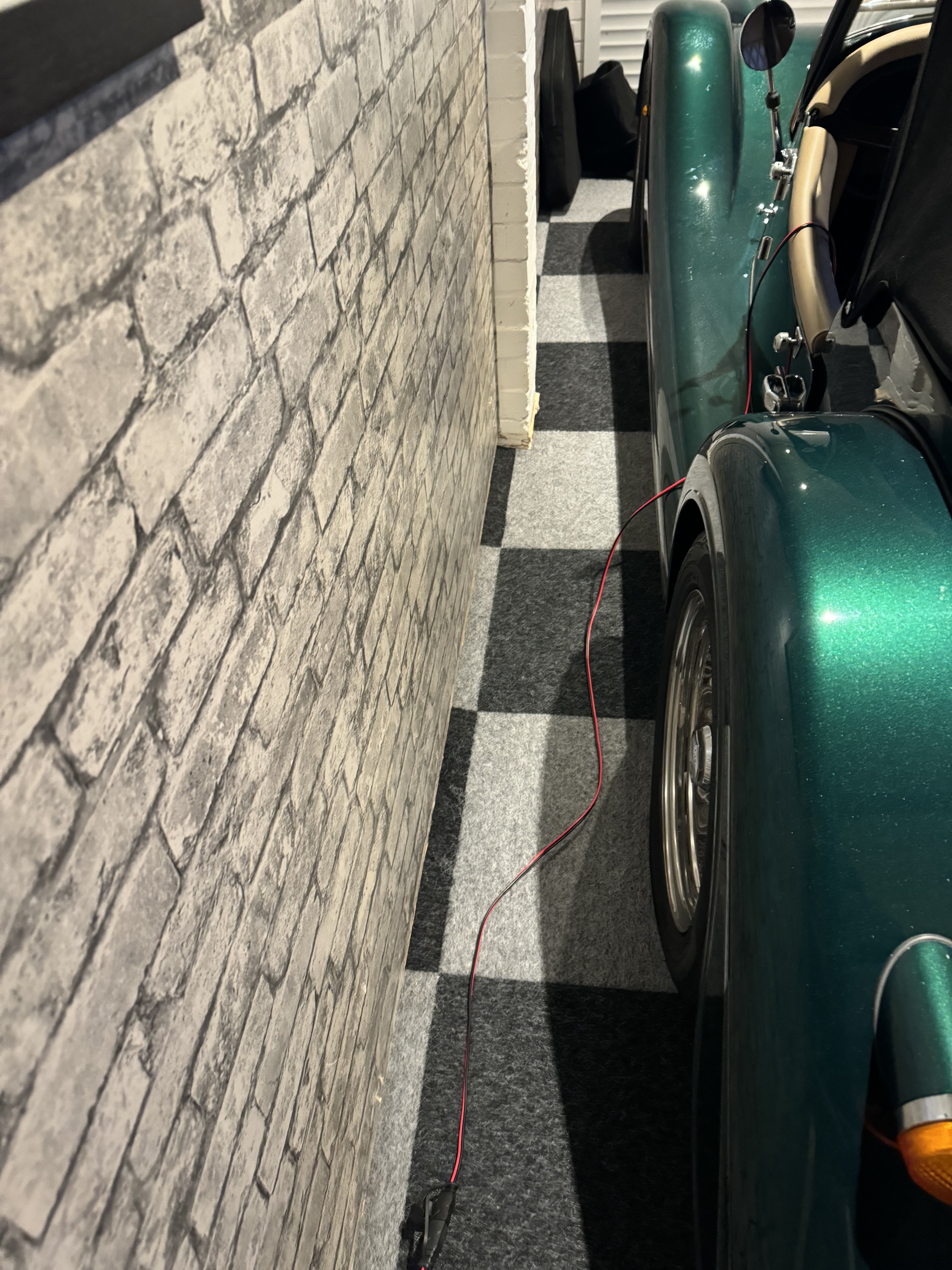

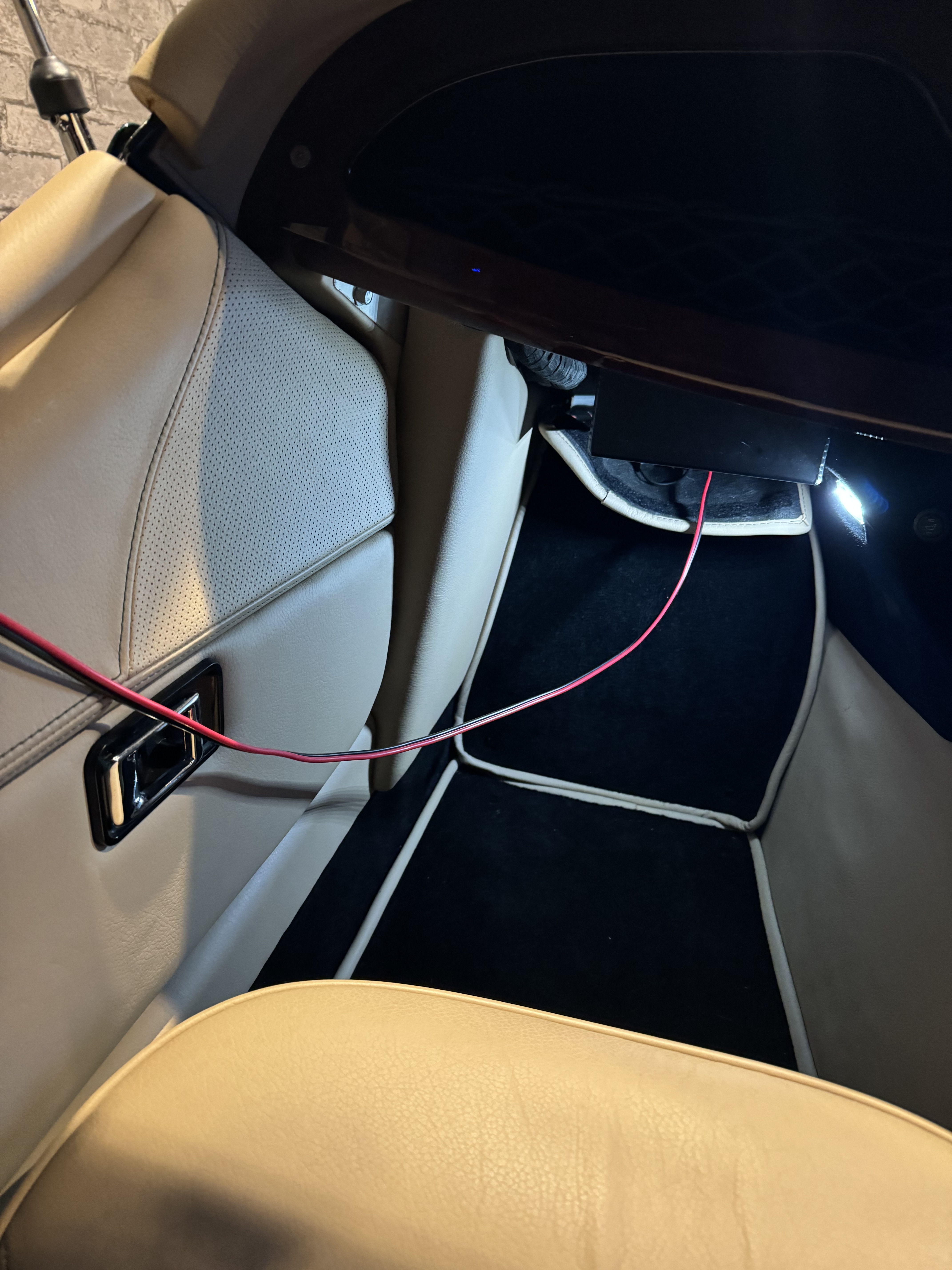

I haven’t attached the Noco Genius 5 to the wall in the garage yet but it comes complete with a nice plastic wall bracket and Velcro strap for added security (the bracket is extra on the CTek), as you can see from the pictures (if uploaded correctly) the plug from the eyelet connectors on the battery comes through the grommet in the passengers footwell and plugs into the chargers 3mtr extension cable.
All I need to do is un-velcro the top section of the carpet and plug it in when I want to charge, leaving the bonnet and strap secure.
I do like the magnetic connection even more though 👍
