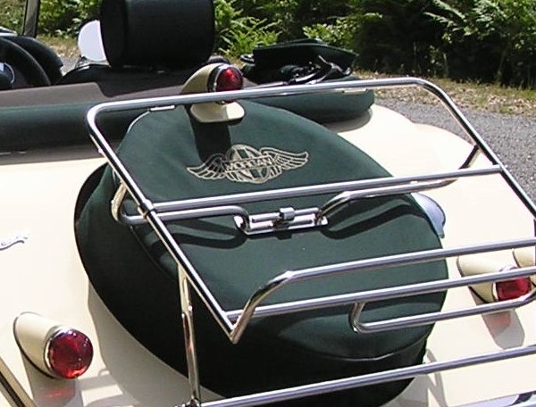

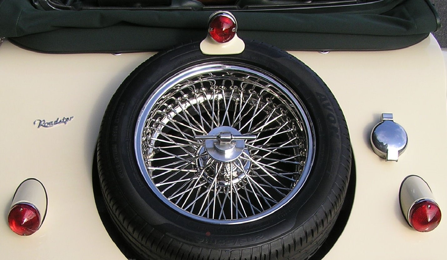

Has anyone modified their Morgan to remove the awful brake light that sticks up over the spare wheel?
It not only only looks horrible but is blocked if you have a case on the rack. On my previous car there were LED strips built into the hood which looked so much better. Will it pass an MOT if I just remove it?

On every trad I've owned I've always taken it off. I presume it's the same fitment, 4 big wood screws and a plastic electrical connector. I always wrapped the end of the plastic bit in insulation tape and poked it under the rear panel. I accept why they're there and I see the benefit......however.....it's an ugly thing and lazy design....imho.... Take it off........NOW...!😁

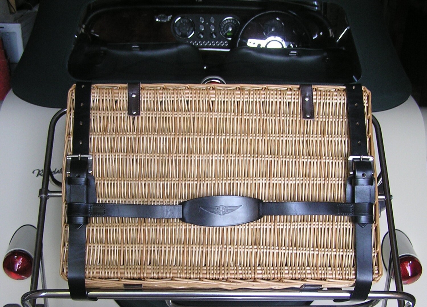

I have fitted a second removable light that goes onto the suitcase. I fitted Superseal connectors to the lead to the “Cobra’s Head” light so I can disconnect it and plug in the other light. The light was an LED one from Carbuildersolutions. I mounted it on a short length of thin hardwood as a base and teak oiled it. I simply strap this on using cheap ratchet straps. It did involve getting access to the existing light connector that is behind the plastic panel beneath the spare wheel. A bit of a fiddle moving that panel but just took care. I extended the wires so the new waterproof connector was accessible. I just tuck the excess wire down out of the way behind the spare wheel. I used it first last month on a trip to Woburn using a suitcase. Simple to swop light connections, only takes seconds. I’ve just got leather luggage straps so will modify the light to use them instead of ratchet straps. I’ll get a couple of photos to post. Just to add that the car is a 2023 Plus Four. Some CX cars have high level lights built into the hood instead. Mine doesn’t. I used to use a Bootbag not suitcase and that was low enough to not obscure the Cobra’s Head light.
