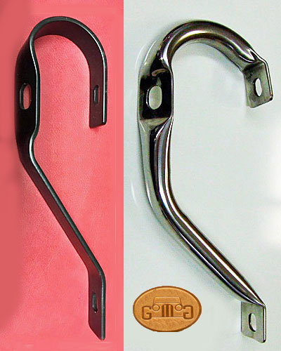

In front, there are two types of bumper brackets. The painted tubular curly things AND the shaped aluminum ones, either in rough metal or painted from the aftermarket. (both below) The original tubular ones were
roughly painted, but later, (aka now) they can be had in polished stainless. The last are the ones I settled on. I did once try to polish the aluminum ones (dealers call them the "flat types") but it will not give one a mirror
shine. I use either professionals polishers or table grinder mounted polishers. I have seen some very decent results for aluminum using baking soda and a polishing pad at the end of a hand drill.
Both types of stock bumper brackets break, unless you don't use your car much. The weight of the bumpers interacts sadly with the bouncing up and down and they shear at the stress point at the bolt. I made discrete
welded reinforcements for both (I have both types, one in spares) that has been fine for 25 years on all three mogs. I no longer use the overseas configuration, even on the cdn car. The MMC and I came up with
something more discrete and suited to the car that offers the production one needs.

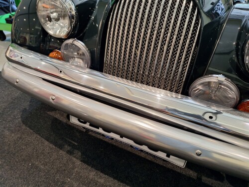

Anodized aluminum....the "coating" will not come off easily. I figured that out even trying aircraft aluminum "stripper". The only real way is to sand them out..... start out with the good old 220 and work your way up to 1200 or 1500. Then hit it with a good aluminum polish. In my case, I used White Diamond plate polish. It will take several days per bumper. And then you have the constant polish requirement to keep them looking like chrome.

Thanks for all of your input. I am wondering whether a gentle flame would lift the coating off. The polished aluminium looks to be what I would like.

Neil ... anodizing changes the structure of the actual metal surface so won't come off like a paint ... you can remove itvusing a drain or oven cleaner containing Hydrochloric acid but that might be a recipe for considerable unpleasantness if the part is the size of a bumper .... I've never done an acid strip ... still reckon mechanical sanding and polishing will be your best bet ... at least they're nice easy shapes to buff without annoying nooks and crannies.
Ps .. still think chatting to a local plater or polisher might save you terminal tennis-elbow 🙂

Lots of options here! To be honest if you want shiny I'd go with polished stainless steel as they really are easy to look after and they often appear for sale on this site as some don't like full length bumpers preferring either over riders or the naked look! I like bumpers so I have full length SS front and rear. Lorne is absolutely correct in that they only protect for the lightest of contact and the rear mounting brackets can easily contact the rear panel if flexed a little too hard!
If yours are anodised well that'll be quite a lot of work and then on going maintenance to keep them like it. Aluminium is tricky to chrome and doesn't stay fixed as well as on steel and isn't cheap. There is a new system around now that looks like a chromed finish, its called silvering and they claim they can silver anything and its cheap! Have a google and see what they say. I have seen it done and it takes minutes and they claim high levels of durability too!
Stainless new with the mounting bracketry are probably about £1300 each so second hand is the way to go and you should pick them up for £5-600 in good condition with the mounting hardware. To be honest its all about the look all options provide, what you like your Morgan to look like. I'm getting on a bit now and like the full bumper look as its a look of my time but if I was ordering now I'd probably go for over riders, possibly on the rear, the simple bumper bar/rack combination.
