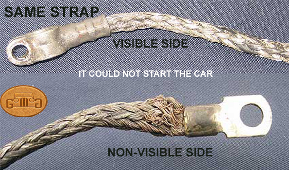

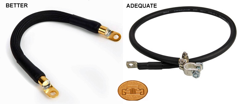

With respect, I have learned early on to abandon all braided earth straps. Three Morgans all seem to fail fcaused by them and diagnosis is made tricky because:
1. they look good..but from only one side
2. They most often show their inadequacy when placing a draw on them..otherwise they test fine. Anything that dubious should be better unless one is a
fanatical traditionalist who prefers inevitable failure to reliability.
As an example, I am showing a braided battery earth strap removed in France, recto verso. It would fail only when engaging the starter. My first such experience
was my first Morgan lesson the day after I bought my first Morgan. In that case the breaded earth strap, engine to frame failed stopping the car cold on the highway.
I use one earth strap to the battery and two from the engine (there are fittings for them at the rear of the all LR Plus 8 engines). We are not the only ones using
these V8s for 60+ years...the other part of that community have become wiser over time. Frustration is pathetically easy to avoid before it happens, laugh2
gmg
[Linked Image] [Linked Image]

I suspect braided cables were designed to be used in situations where a high degree of flexibility is required, and in most cases I have seen they tend to be uninsulated. However I guess in vehicular use the lack of insulation/protection may expose them to corrosion. i.e. in parts of the world where salt might be used on the roads in Winter..?
Where a similar degree of flexibility may not be required an insulated flexible cable with heat shrink over the junction of cable to its termination will be better protected from such corrosion.
In the case of the need for a a highly flexible cable used as a earth return, there is generally no reason to insulate it, as contact with people or surrounding metalwork provides little to no potential issue of electric shock or short circuit..
As per gmg`s kindly supplied image... Many occasions of electrical circuit failure, tend to be caused at the point of a junction, such as at the the terminal that is crimped or soldered on to the end of the cable, or where that terminal connects to the component to be supplied with electricity.
Looking again at gmg`s braided cable pic, it seems perhaps possible that the point of connection braid to terminal, has suffered some reduction in current carrying capacity as a result of fraying of the conductors at the terminal, perhaps due to age..?
Any reduction in the Cross Sectional Area, of a conductor ( section cut through the copper wire) can lead to overheating at or near the point of partial failure, (reduction in c.s.a.) and in time along the length of the conductor, which generally shows up initially as discolouration at the point of failure, which can be masked up to a point by insulation until things really begin to heat up.
Once again using the image of the failed braided termination point, it seems a tad unusual for discolouration not to show all the way around the termination prior to total failure, perhaps a fastidious owner who likes to keep his engine bay clean and tidy, if not sparkling, might even have cleaned the accessible area of the braided cable termination which may have masked the issue as it progressed with time...?
