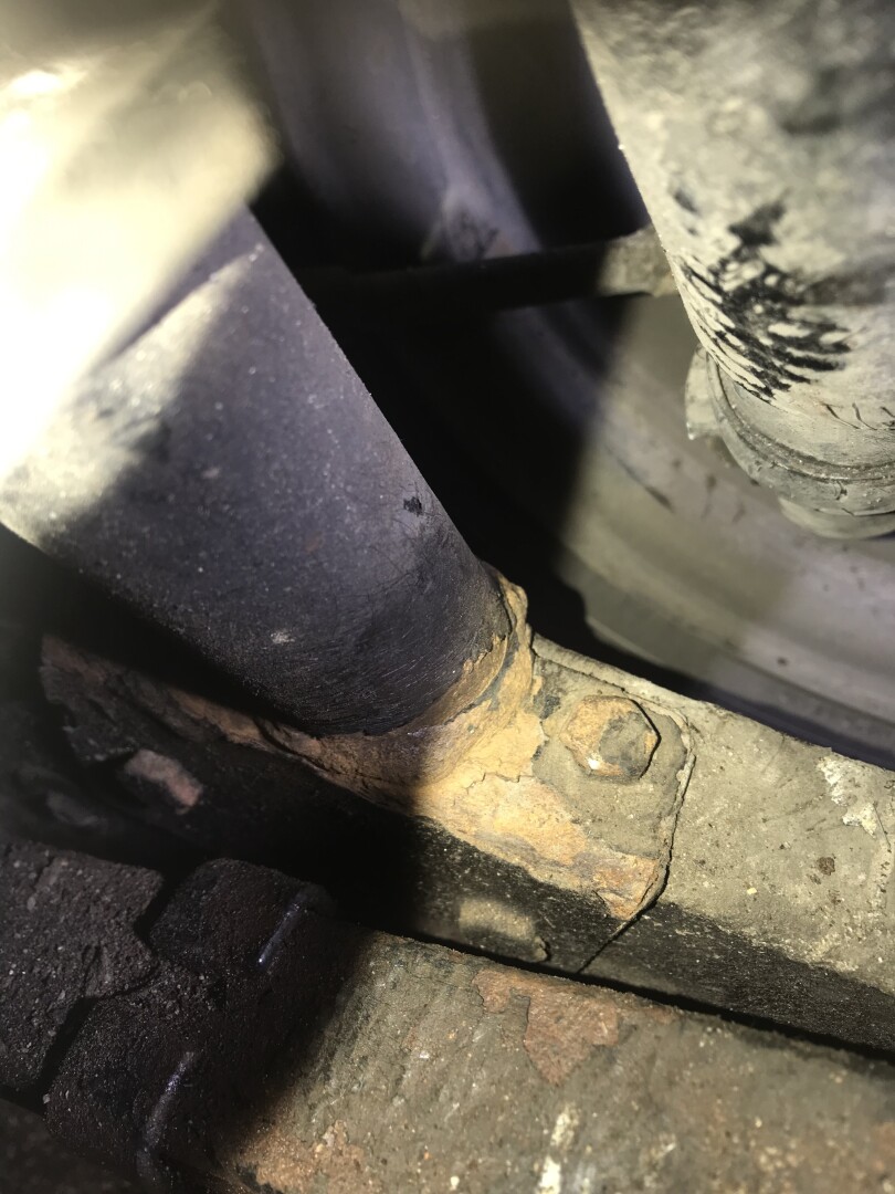

Very poor weld penetration Morgan!
Both sides too irked

On close inspection of the failures, it was immediately evident weld penetration where the hoop tube ends were joined to the chassis mounting brackets was nonexistent!

As my car was delivered just before yours, Montegue. Thought I’d better take a look at MMC welding on my hoop.
Mmm not great. (Off side)

I'm not defending the Factory (MMC) but the hoops are bought in
Probably the same Co that made the tubular Three Wheeler chassis with latent cracking issues hide
1 member likes this: OZ 4/4
CooperMan #819863 18/03/25 09:55 PM
Posts: 7,342
Likes: 49
Posts: 7,342
Likes: 49
The concern is that the factory accepted the quality of the welding and went on to fit it knowing it was rubbish......
