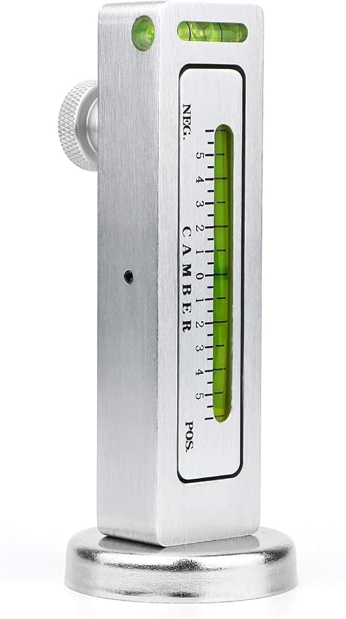

According to the parts book adjustable camber plates and matching kingpins were introduced in May 2011. Given you have a 2013 4/4 it should have these. Camber measuring tools, as below, that magnetically attach to disc are available via Amazon or eBay.
Chassis needs to be laterally level though and as John mentions steering dead ahead. Handbook confirms camber at 0.5° negative.
Note the rounded top of the kingpin each side forms the pivot point during camber adjustment, if necessary. Kingpin top bolt as well as lower nut need to be loosened a little therefore before adjustment can be made. Worth checking tracking as well, best performed at a garage/tyre shop equipped with laser measuring equipment.

Problem is you need a laser flat garage floor and you can't jack the front to get better access to nuts during adjustment as it twists & bu66ers up the alignment, I've got one of those magnetic camber tools Richard shows above and to be honest they ain't very accurate by the time you swop it from one side to another and try to read just half a degree
I just use it for 'roughing up' the geometry if I've had something major apart and then take it to the pro's for a 4 wheel jobbie
