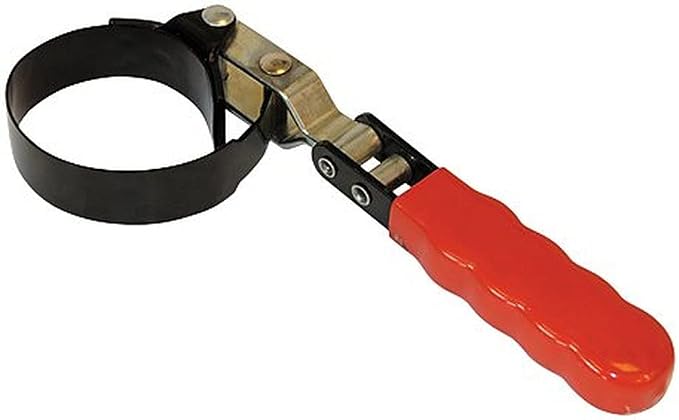

No need to get angry with screwdrivers and chisel. This inexpensive strap wrench tightens grip as you turn.
Similarly when fitting new filter with well lubed rubber seal, just tighten until seal starts to compress and continue 3/4 turn by hand.
100% agree with this, The metal "strap" is great to squeeze into the tight space around the filter.
