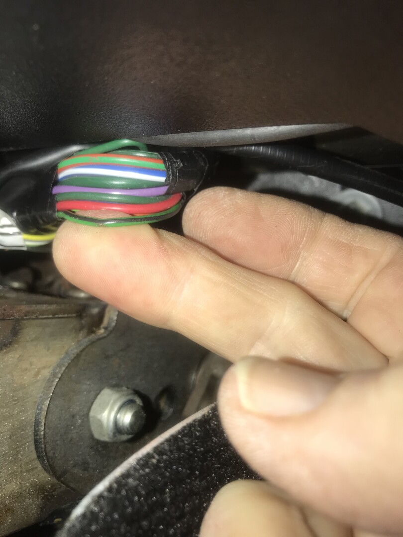

GKT, not sure why you are asking, but your +4 should be similar to my 4/4.
I had real trouble with my washer pump shorting to earth a couple of years ago.
The culprit was under the dash as the loom goes over the steering column.
You will have to expand the pic to see the damage.

Yep, I've had both those issues. The wire on the steering column, took me ages to find mainly because you don't use them much and you needed the heater on volcanic, that's when it softened the cable and allowed it to make contact.
