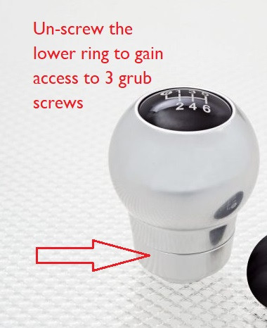

Originally Posted by planenut
It's a time since I removed it but from memory, no threads, just a plain shaft. It's held on with the 3 grub screws through the collar.
Like this:

Martin,
you will find below all the useful information regarding my purchase of a Gear Knob from Basil coffee :
https://www.talkmorgan.com/ubbthreads.php/topics/799359/1
There are no set screws to fix the knob, just a first threaded aluminum ring, which serves as a locknut. idea
[Linked Image] [Linked Image]
