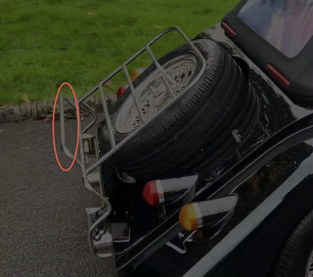

I'm considering looking at putting a clippable high level brake light/ running light on the luggage rack upper ledge bar as shown here and run the wiring along the rack framework. I was following a CX Morgan on the motorway in very heavy rain on a misty night and the amount of spray being generated at night and it's dark colour, I often lost sight of it in the rain with only the very small lights and number plate illumination to give it's presence away. I'm not quite sure how but I'm sure there is something out there, its a matter of finding the right size clips for the luggage rack.

I used this LED strip mounted on a wooden batten that straps to top of luggage to replace obscurred cobra.
It offers wiring as tail light (50% lower intensity) as well as brake if fitting permanently. Should be easy to tap into existing tail/brake light wiring.
Good call, but perhaps the CX could have popped his fog lamp on? Similar position.
Steve Saunders had a modification where the high level third brake light is above the rear window. As he said, the purpose of the high level light is not for the car behind you, but for the cars following the car behind you. Lovely idea, but works best when the hood is up.
