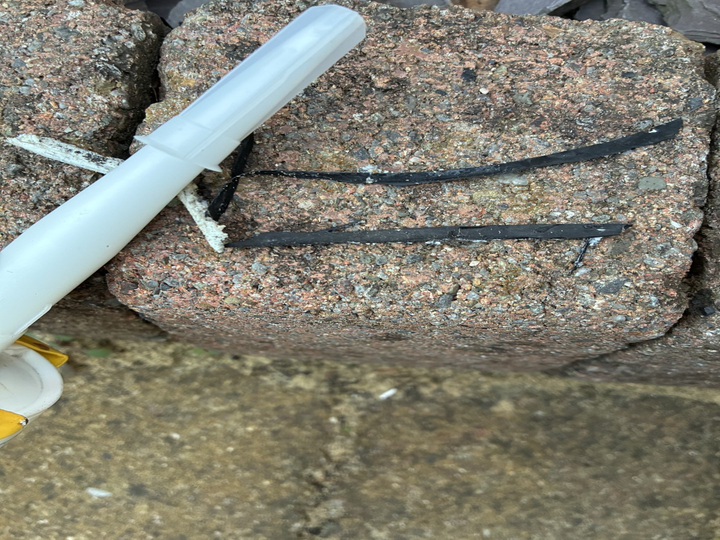

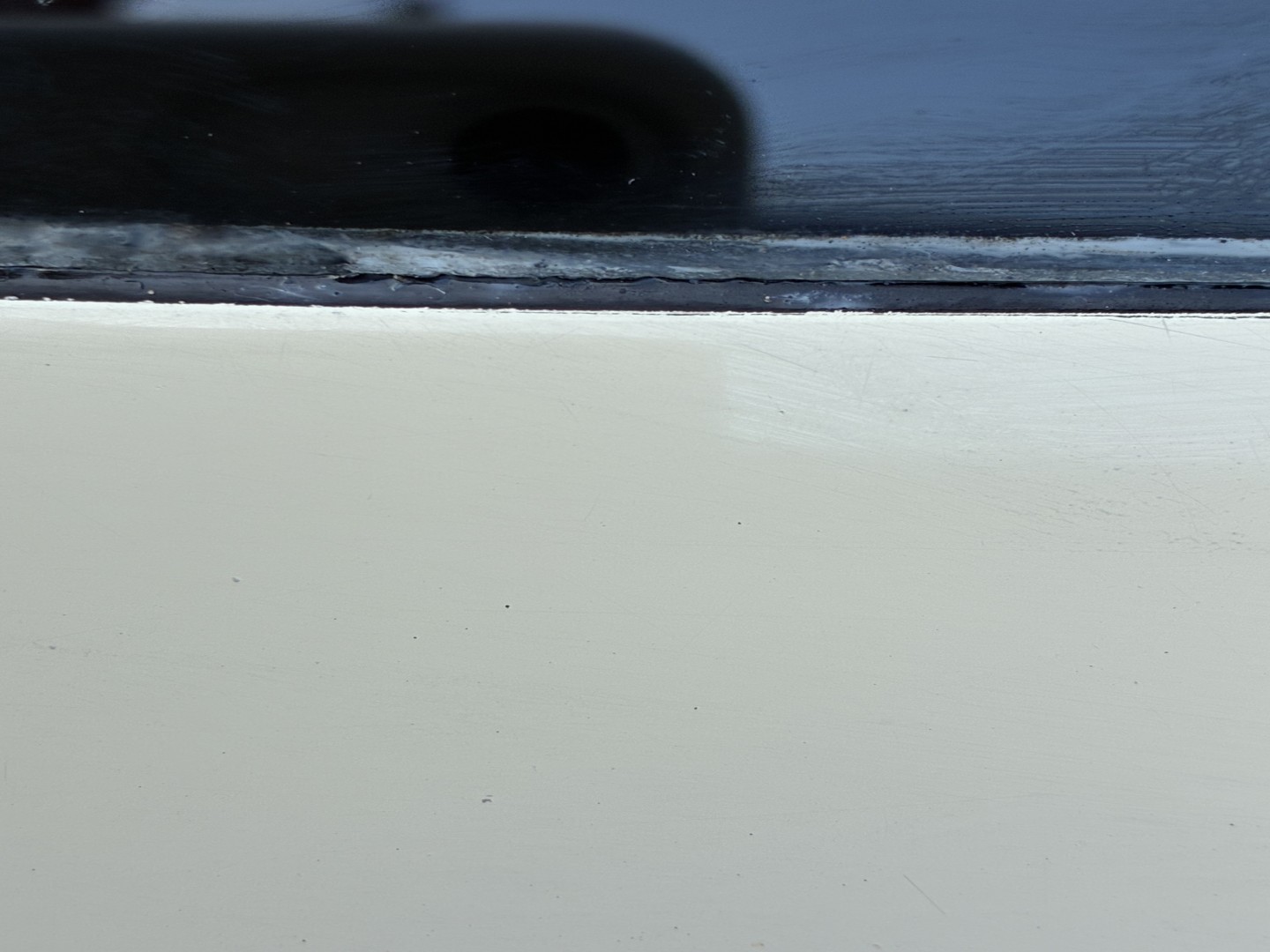

Thank you very helpful. Trouble is the toughened glass is just about the size of the hole. <mm difference.
The original seal is very fine. Hopefully pics explain.
You can see how the lip has perished on the little bit still just there. Plus some of the bits with the mastic gun to show scale.

That looks like a liquid rubber mastic to me, you are just removing the the set rubber forming the adhesion and water seal.
