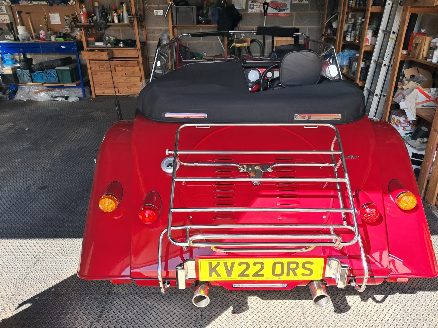

As long as you have the triangular brackets near the exhaust it is easy.
I have ringed the bracket in blue in this photo. If you don't have it I guess you have to cut the valance & weld it on both sides

This is my PlusFour in build, the brackets are mounted on those black "studs". I don't know if these studs are present without the luggage rack equipment? It is easy to check if you look underneath the car!
