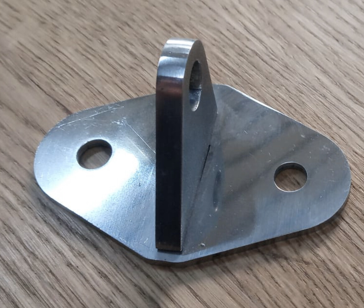

Clemens on here in the Black Forrest will have all the information on this and a warning about the factory supplied bracket that failed on him whilst on tour.
A reference to a further failure here from Robbie.
I don't know how the mounting works on a 2025 model. The important thing is that it's not just the inner part that's welded. The T-piece needs to be welded all the way around.

Just to endorse what Clemens said re the welding of the bracket - Both I and a friend who has a cxPlus four have had the brackets welded like Clemens - the way that they are supplied is that the back of the bracket just has a "Spot" weld on the tongue and it is not sufficient at all. --You have been warned!!!!!!
