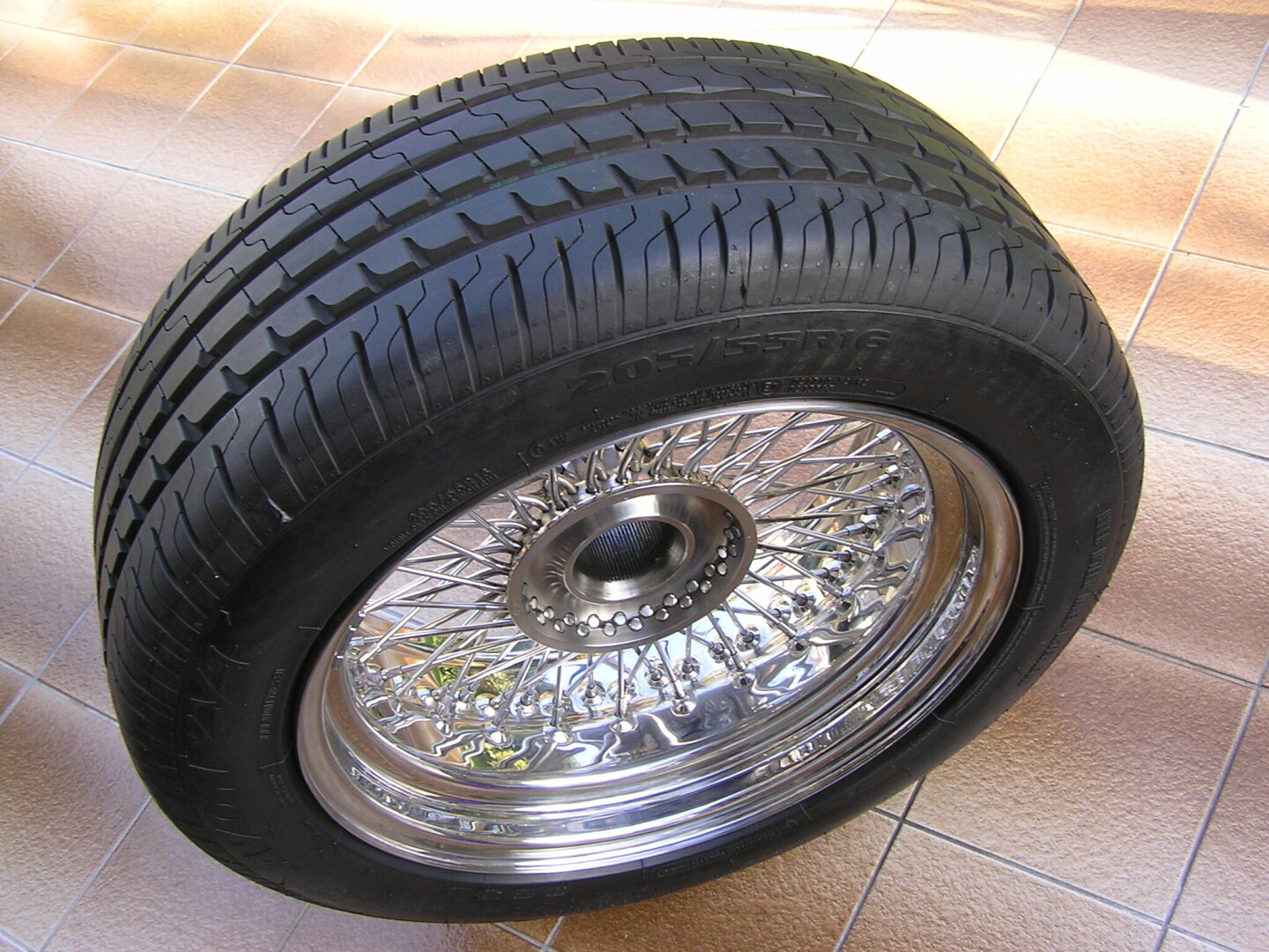

Dragons Breath is excellent stuff, this is what my wheels look like after their annual deep-clean. Use as directed, and don't be tempted to leave it on too long before hozing-off.
