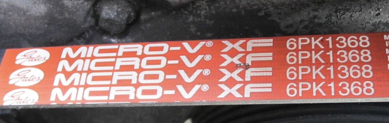

Very strange. My 2005 Plus 4 belt is
Ken
