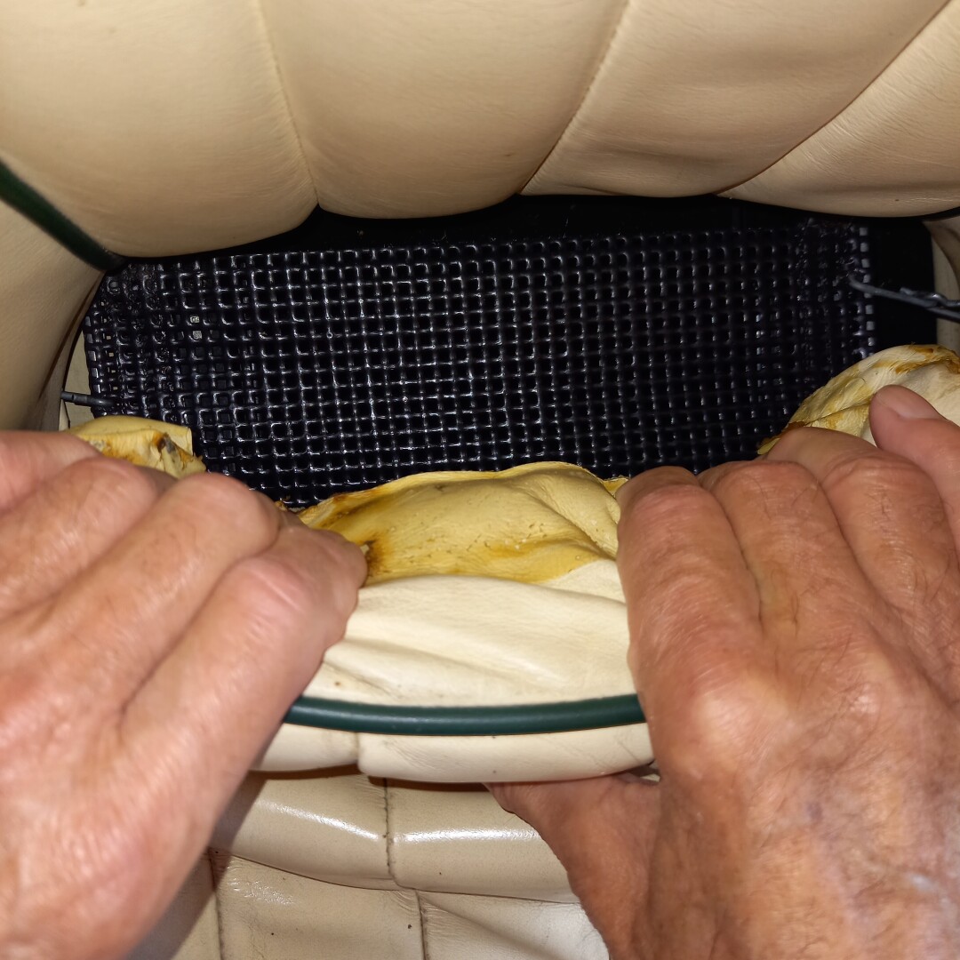

Hi Chris
I have a 1999 4/4 Zetec. On my car there is no webbing. The seat cushion is supported by a diaphragm. This is like a piece of netting that is held to the metal seat frame by metal hooks. You can check if you have a diaphragm by pulling the seat cushion back at the rear where it meets the seat back see photo. My drivers side diaphragm in my car split a while ago so I took the seat out and took it to a local car trimmers and they replaced the diaphragm.
Regards Tony

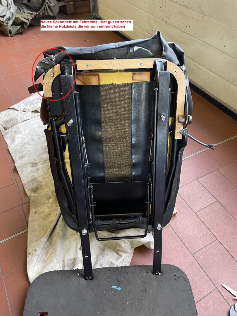

I got this Foto of my seat webbing From Frank Schauer from Morganpark.
Sorry but I on my mobile I can't show it direct...
www.tm-img.com/images/2026/06/29/IMG_8425-e1c3196f.jpg

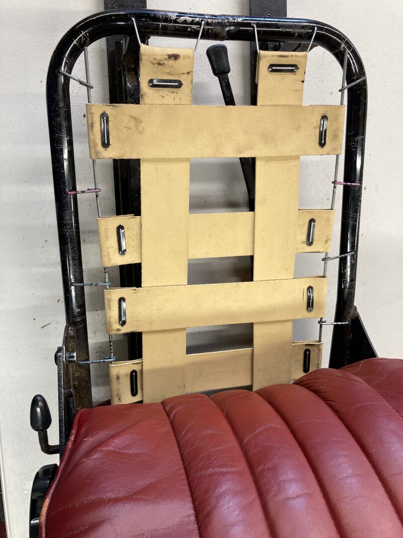

I did mine a while ago very easy to do Pirelli straping and clips from woolies
DB

Originally Posted by Mkiss
it is an easy fix...
laugh2 It is also a easy problem to cause to occur. The original stuff is called Recaro SR3 Seat Webbing
Splitting it is very common to trads where the seat does not pleat forward and offer easy access to the rear compartment of the axle. Those owners (I was once one of them) place their knee in the middle of the seat to gain access to the rear area of the car hen the top is up. This practice inevitably splits the original webbing. https://www.gomog.com/allmorgan/seatrepair&removal.html always does.
I am happy to see another webbing type. Does it produce a different feel?
Once, when mogging very far from home, I did an emergency repair by weaving (crisscrossing) the bottom of the seat with the plastic cord they use with a lawn clipper. It was so comfortable that I forgot to change it for 2 years!
