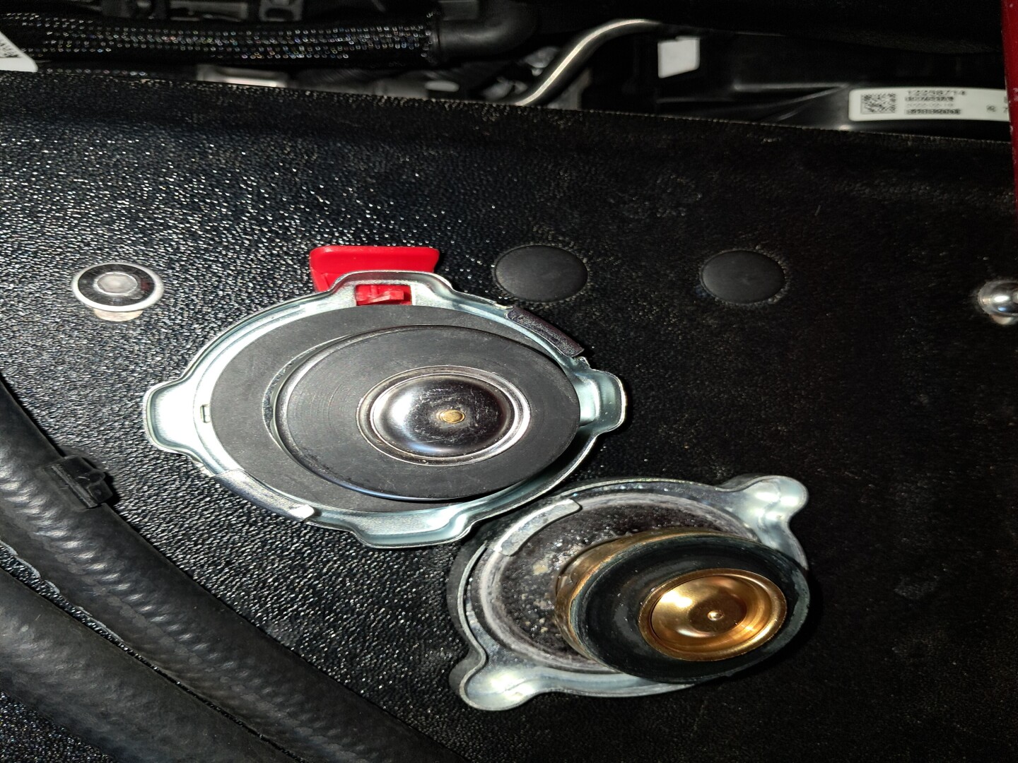

Here is my post on rad caps
The monthly newsletter from SwanMog reminded me that the original rad caps on cx cars are known to fail. The supplier is Tre. On my car the high pressure 28psi cap had already been changed to a Stent one but the low pressure 16 psi one was from Tre. I replaced both with new caps from Motorad who took over Stent. I went to Merlin Motor Sports. The low pressure cap showed signs of leakage with coolant in the drain tube and on the cap inside. The Motorad one has an additional rubber seal and is far better quality. The coolant was at 1/4 so I topped it up. It will be interesting to see how it goes.

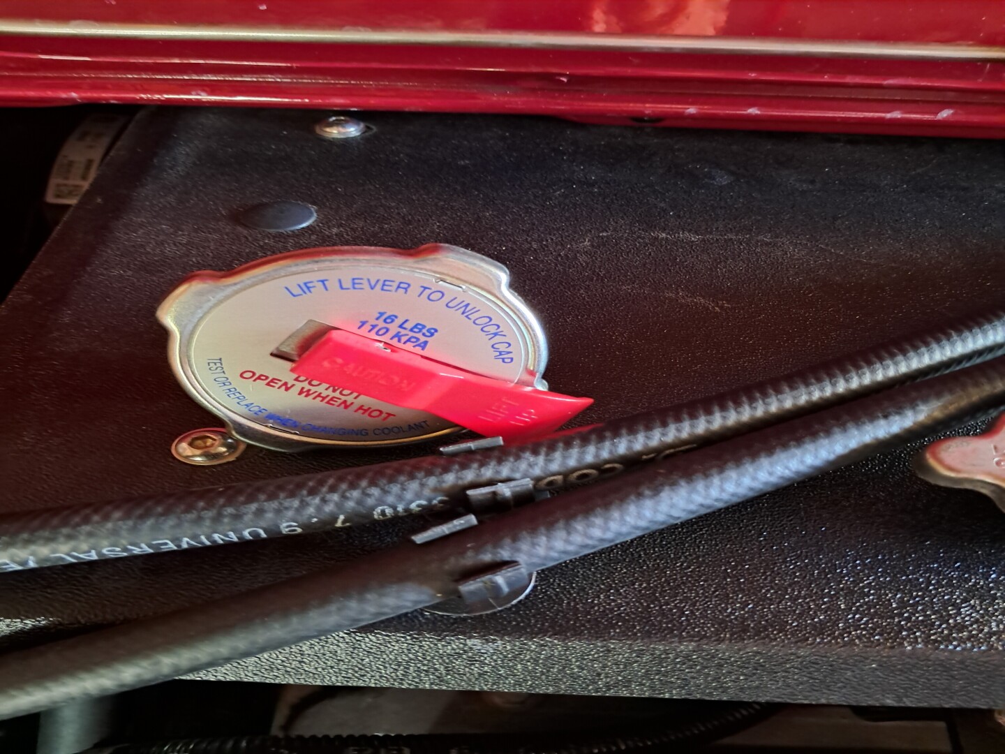

Just a heads up that the rad cap pressure seems to vary year on year, model by model; possibly what MMC had in the parts bin ...
Mine were both 16 psi by Tre (now changed to Stent). Seeing a car in build at the factory with a higher pressure cap caused me to ask if both of mine at 16 psi were correct, the answer was "yes".
I've never had a radiator issue. It would be interesting to know whether CX Mogs with high(er) pressure rad caps have experienced more rad failures than those with low(er) pressure rad caps.

Mine has had 1 rad & I have 2 differentt pressure caps
