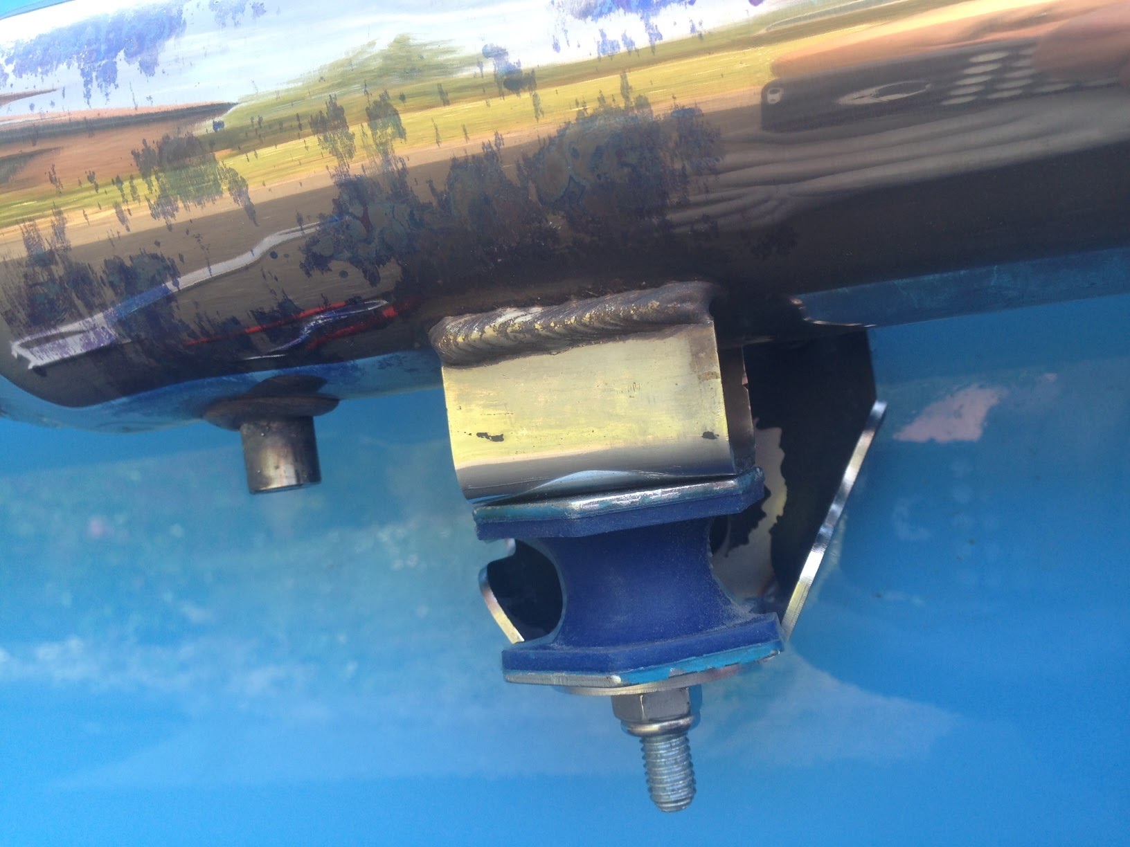

I first tested the silicone rubber mounts on the original exhaust, then on my homemade exhaust thinking :
Then I completely removed the Rubber Mounts innocent :

Will be interesting to see the long term impact on the alloy body without rubber in the mounts.
Plus the risk of additional heat transfer & cooked paint
1 member likes this: Bitsobrits
