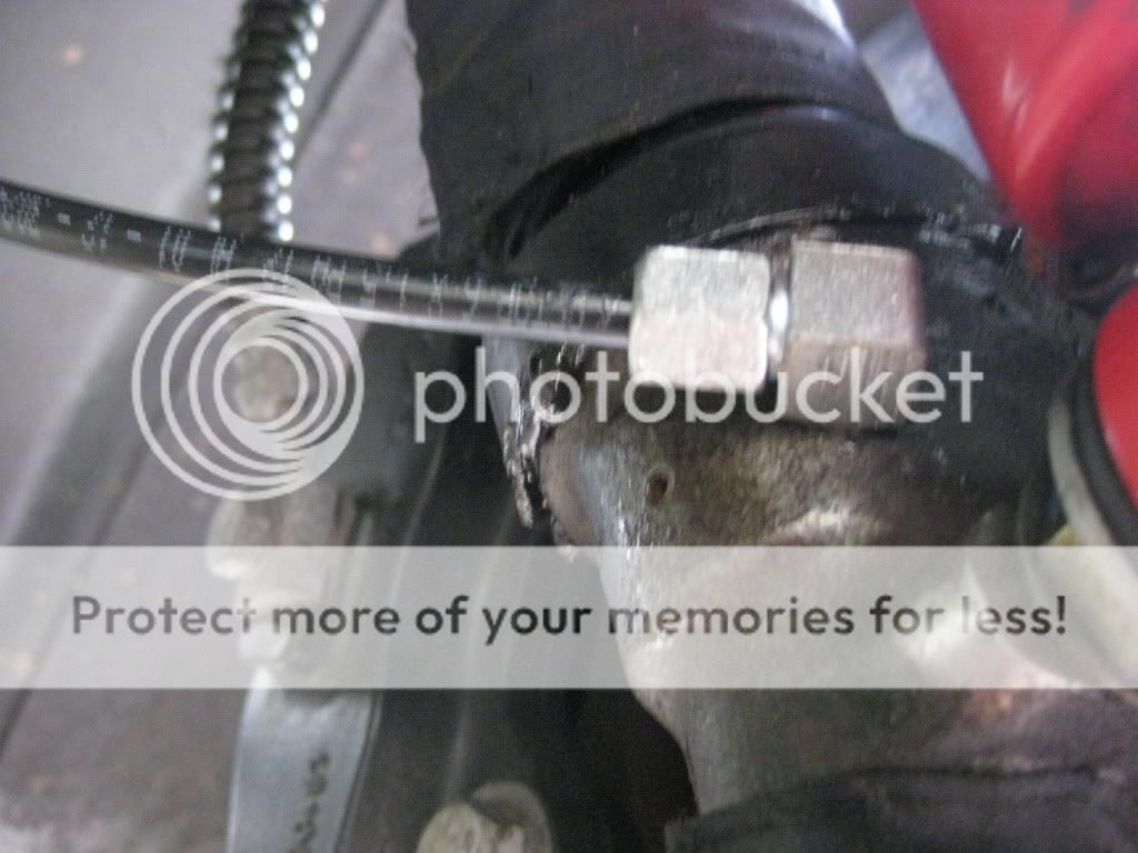

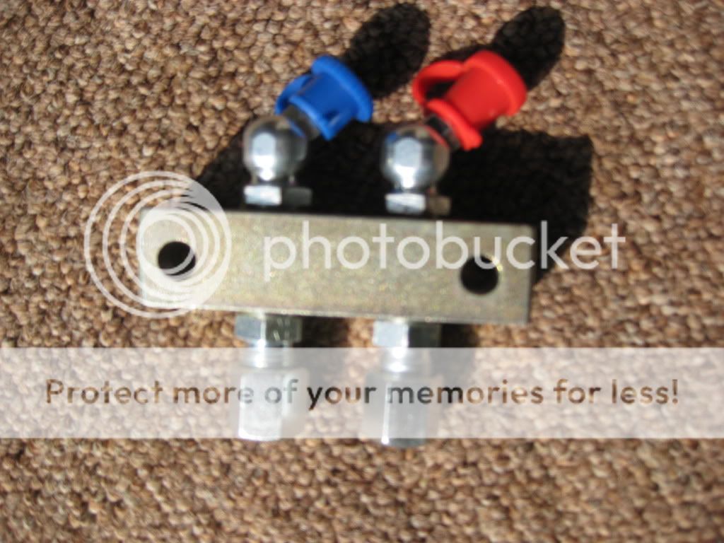

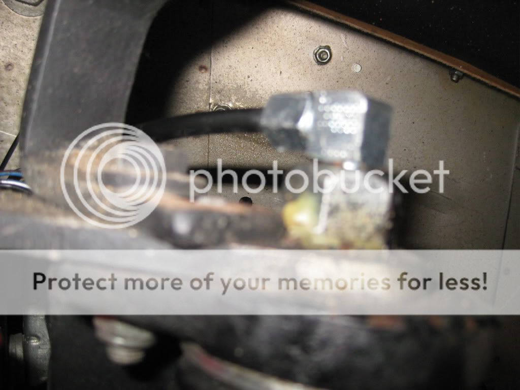

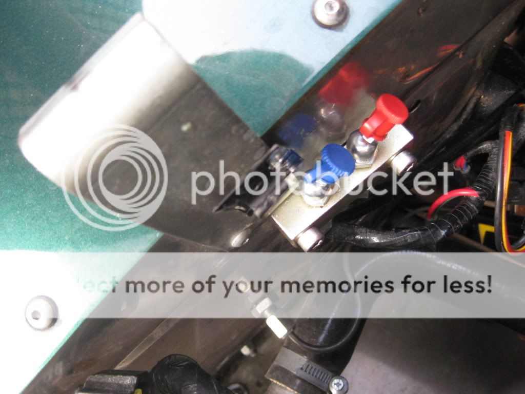

Having the benefit during the 5 greasing sessions I had to make on the Grade Tour I have to recommend the Remote Greasing Kit as supplied by the Nipple Shop (£60).
Lift the bonnet each side and it is easy to access the nipples.

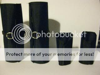

With DaveW Gaiters fitted to the Bump Springs, the excess used grease only appeared around the lower edge of the Gaiter. with a small kneeling mat it was easy to wipe off without getting near to the Brake Disc.

That kit looks great! Found it on the site (link: remote greasing ), but there are two versions:
NS9000MOG. For bearings with inlet thread:
1/4"unf, 1/4"bsf, & M6x1
NS9024MOG. For bearings with inlet thread:
1/8"bsp
Anyone know which kit/inlet tread fits a 2011 plus4 sport?

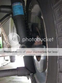

Greasing completed (I think)!
Got grease into both top nipples, black(ish) grease came out at the bottom just below the top spring.
Got grease into both bottom nipples, same blackish grease came out at the same place below the top spring.
The attatched photo shows the place where the black grease comes out (with the amount that came out before I stopped greasing).

Now clean the camera smile
