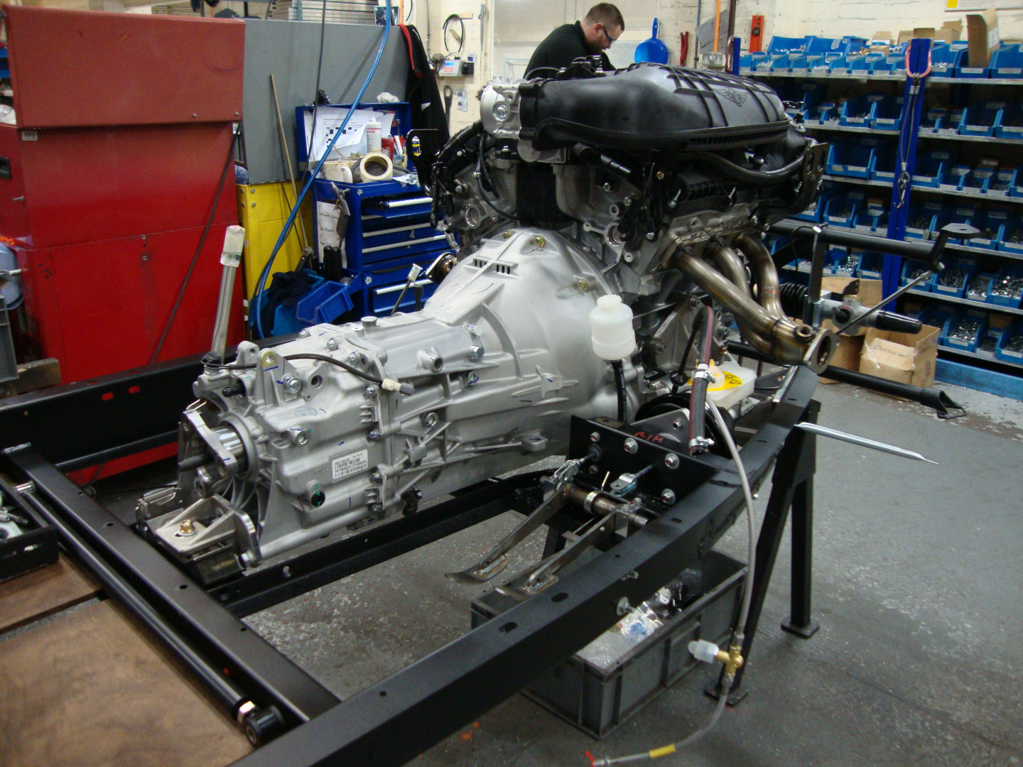

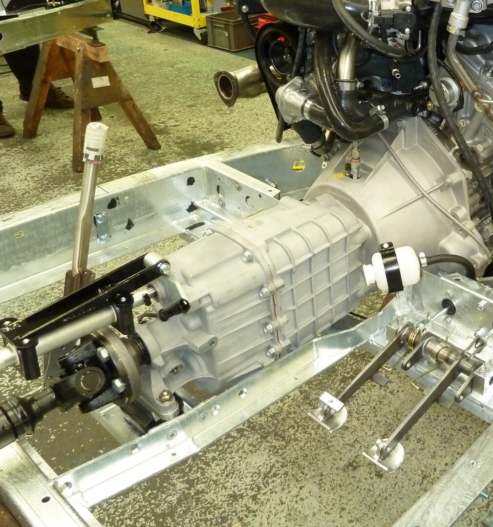

#820883 Apr 2nd a 08:46 PM
by CooperMan
Originally Posted by BigLes
It's a 2018.
Here you go Les, couple of shots of the 3.7 gearbox from a 2018 build (Dave's photos are from a 3.0)
Access will be difficult to that front output coupling flange / propshaft bolts
1 member likes this
