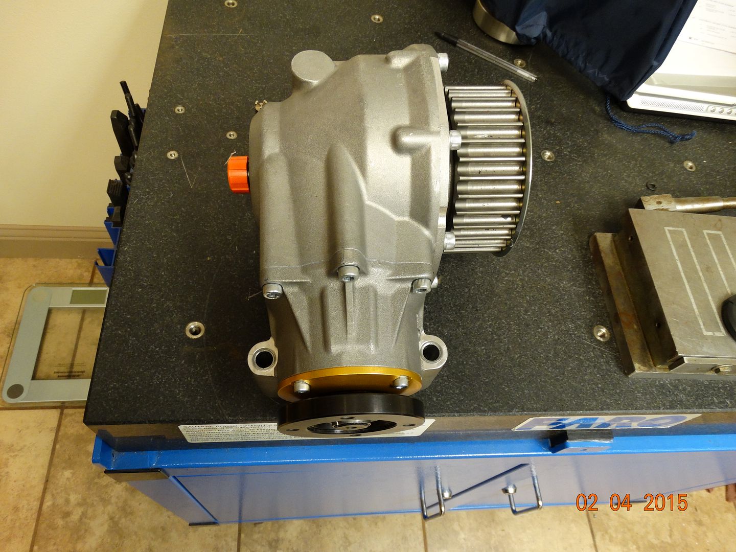

If you look at the bevel box below and squint your eyes...what do you see? Slightly resembles a GL1800 final drive?
At a quick glance and considering the center-line of the GL input shaft...after removal of the brake rotor and caliper bracket, it would provide ample room for a sprocket adapter off the FD...can't be any worse than having a loaded rear wheel hanging off of it.
I have thought about trying to morph a GL1800 swing-arm and final drive into the M3W but then you have drive shaft offset issues to deal with. With an adapter bracket, input flange and a flange to hold the sprocket, why couldn't a GL1800 final drive be substituted as a bevel box?
All this time, I wanted the full swing-arm to run a GL1800 wheel (with run-flat car tire) while eliminating the OEM bevel box and just over looked using it as a bevel box. Couldn't see the forest for all the trees.
The GL1800 FD is robust enough to deliver power to the rear wheel while dealing with the stressed loads of a 900+ lb. bike flying through the sweepers at 90+ mph (with two gravitationally challenged people on board)and towing a trailer. I see no problem it supporting the torque loads of a drive belt.
The gear ratio for the OEM bevel box is 2.0:1...the gear ratio for the GL1800 is 2.75:1 (33/12). The new swing-arm/final drive (trike pull-off) in the pic was less than $100 and are easily sourced. As you know, the GL1800 FD has a proven track record of high mileage service even when neglected. My buddies and I usually change them out at 150K miles just for general principle and considering how cheap they are but many I know of have seen upwards of 300k miles without a failure. It would require some final drive sprockets to bring the rpm's back in line but not the end of the world to have a reliable box that is quite. The GL1800 has two over-driven gears (4th is .843 & 5th is .686)...best I can gather on the Mazda 5-speed box, OD is in a range of .83 to .85.
I know it seems overly complicated but a current bevel box replacement is taking a failed product out only to put one identical to the one that failed back in. And a quite bevel box with 10K miles on it might not be so quite or reliable with 50K miles on it.
