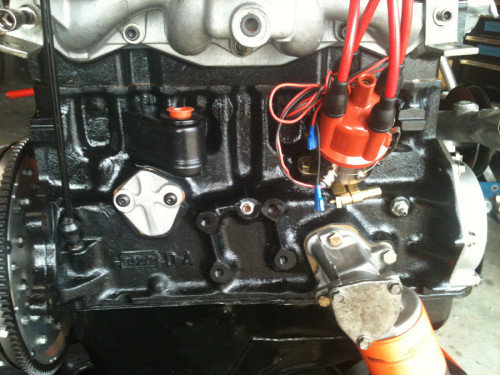

If you not even getting a stutter with Easy Start - then I'd suggest something is wrong with the ignition system/firing order/ valves/ timing.
The mechanical fuel pump is located on the same side as the dizzy - where the diamond silver blanking plate is in this picture.
