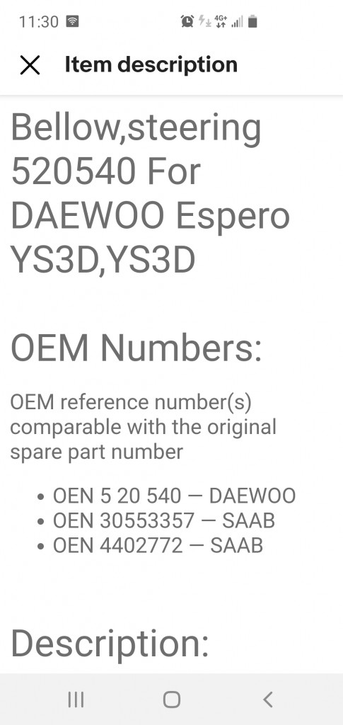

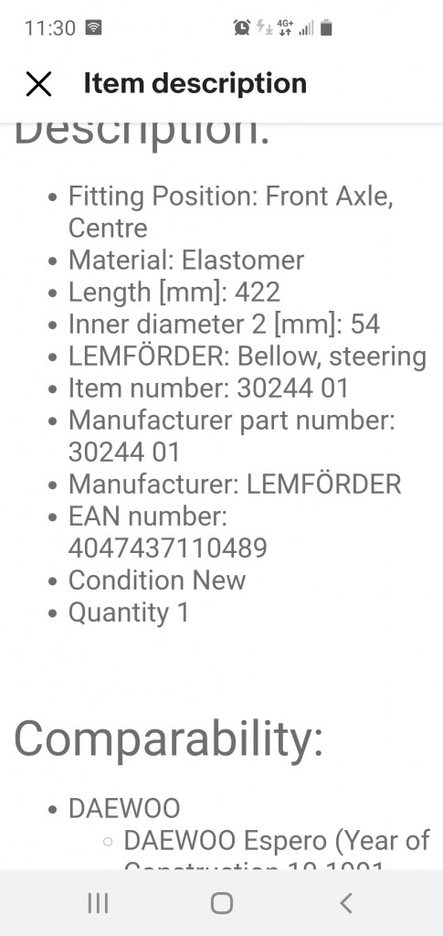

Hi IvorMog
Yes no problems with full lock. Its a Saab 93 to 2002/3, or Daewoo.
I'm still refining the fit. The Lemforder Gaiter ends have an ID of 54mm, the JK Rack is 38mm OD
so I castellated the ends to close the gap, and double tied. I'm in the process of sourcing split collars to go inboard of the mounting bracket
to increase the OD of that part to 54mm. I was thinking aluminium from stock billet with a couple of clamp screws, to keep it professional,
but I think I may end up making ply prototypes as the lathe engineers I've contacted can't seem to grasp the concept.
Maybe someone on here can turn them out?
BTW, I may have found a clearance item at £9, as most seem to be £20-30, although the link above may be the last at £15.99.
but still good value at £30.00
I'll switch to stainless hose clips for the final as well.
I`ve just done the centre bolts to the rack hand tight plus a pinch to line the flat.
s up on the lock tabs, and used tell tales.
The feel of this gaiter is much more robust than the JK affair.
Details and specs below

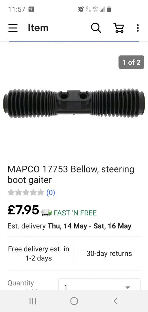

This may do also, although shorter at 348mm as opposed to 422mm, may be spread the bellows out a bit? to mitigate compression
