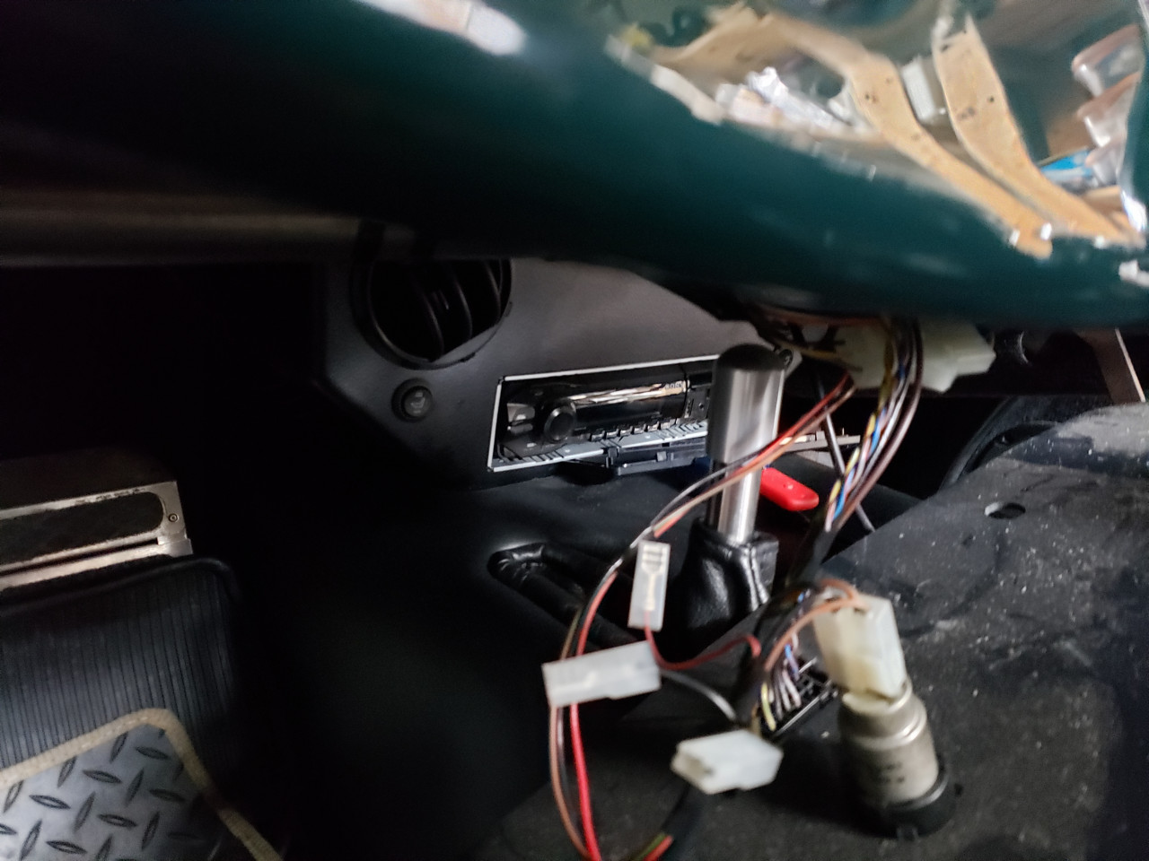

Being bored in lockdown I ordered an MMC start button for the Roadster. I have always wanted a car with a start button. Sad I know .
As the 3.7l cars have a jumper lead on the plug behind the dash it should simply be :-
1. Remove the under dash panel by undoing the screws.
2. Remove the plug on the dash
3. Remove the jumper plug and fit the switch
4. Reconnect
What could go wrong after all it is a Morgan.

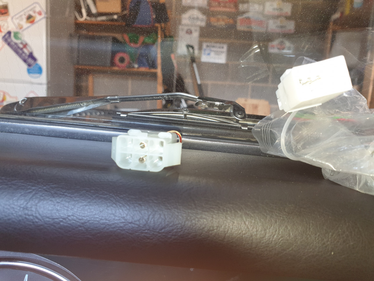

Alas BHM had the wrong switches from MMC despite the right part number and as you can see the plugs are very different.
.The jumper on the dash roll & the wrong switch connector

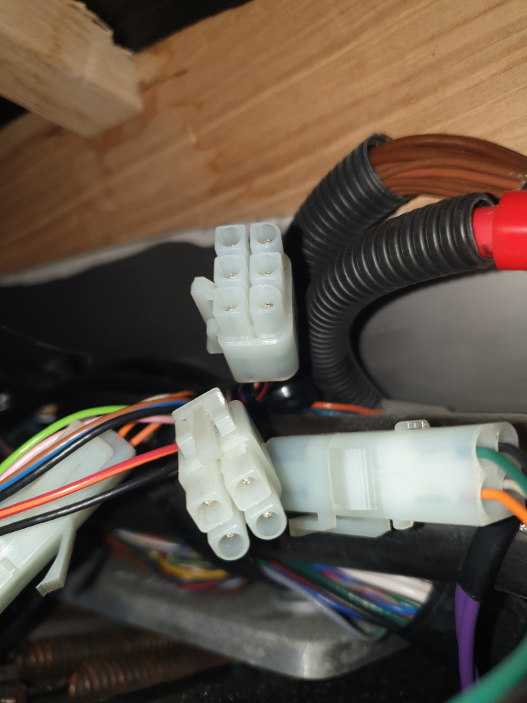

The six pin connector under the dash.
Sarah at BHM was very helpful and a few days later the right switch arrived was fitted & works.

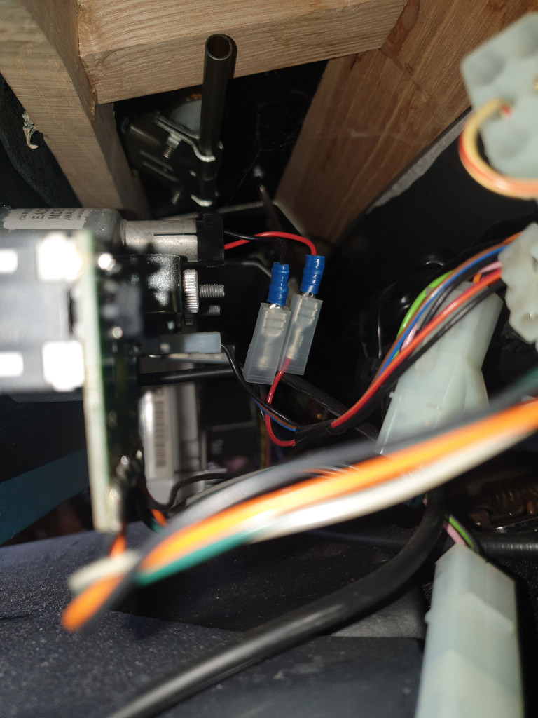

Under the dash showing the PCB in the correct alignment
PCB facing up means the flashing green light on the switch before you start doesn't work. Naturally you will have noticed this feature before you put it all back together. If you do that wrong & refit the under dash panel you need to take it apart & get it right. Don't ask how I know.

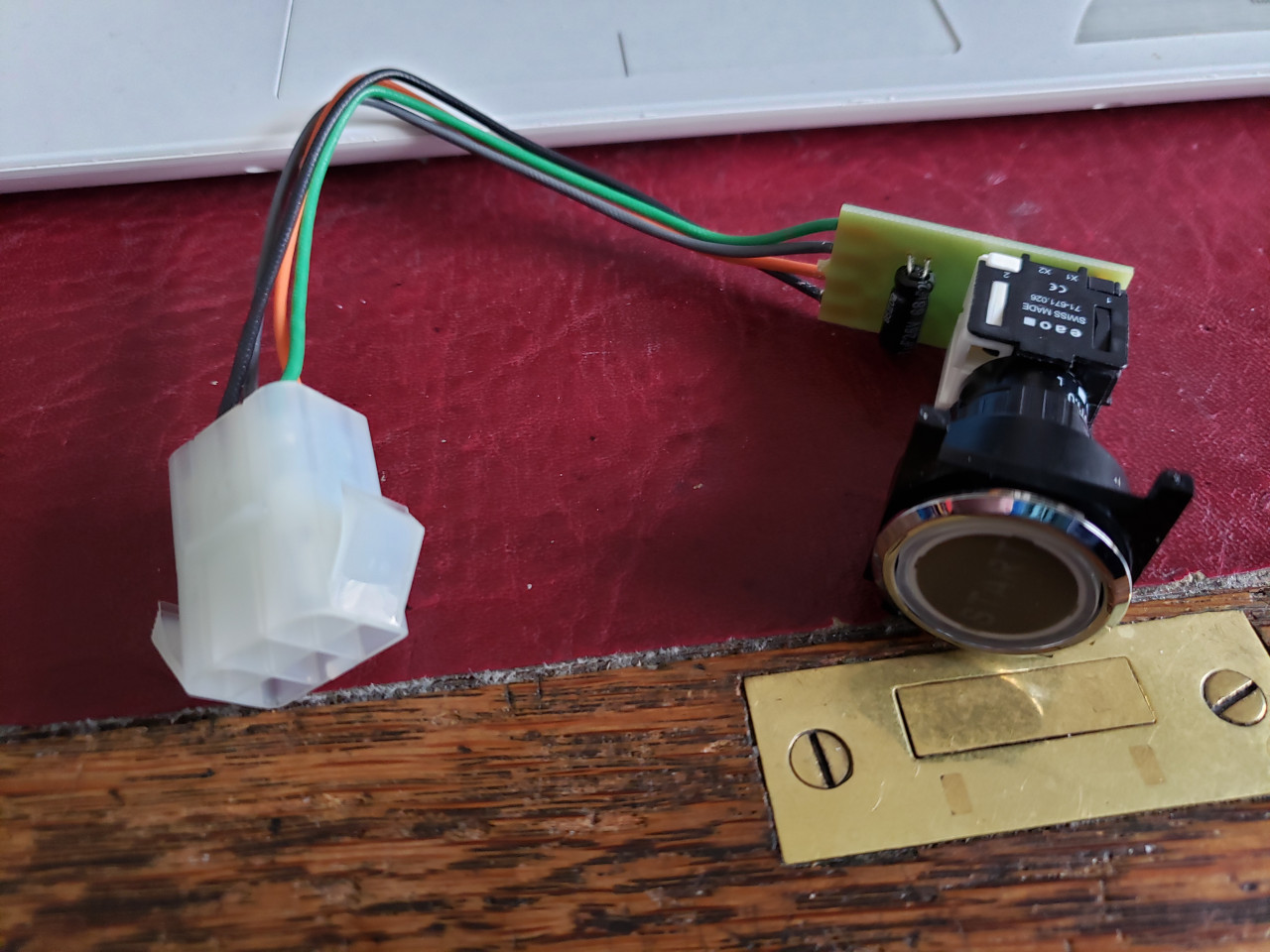

The right switch

It splits in 3. The square bit below the pcb is held on by a plastic screw to the main body of the switch. Then there is a round threaded nut that unscrews to go behind the dash.
