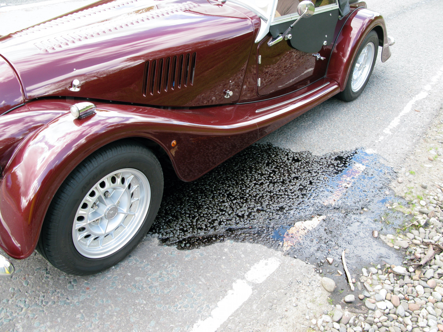

Allon Whites did mine when I bought the car off them. It is essential as otherwise you will hit the sump
Posts: 1,245
Posts: 1,245
John's correct. I did! Mulfab sump fitted as a result.
[img][img]https://tm-img.com/images/2022/06/17/2010---201.jpg[/img][/img]

The skid plate is essential.
I know of three Roadsters with instant oil loss via cracked sumps - hitting boulder under grass in field/hitting speed bump in roadway/hitting gate stop exiting parking area.
