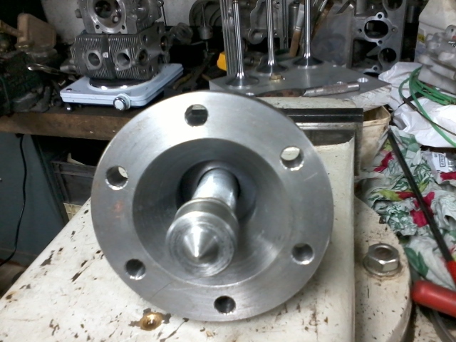

Posts: 786
Likes: 18

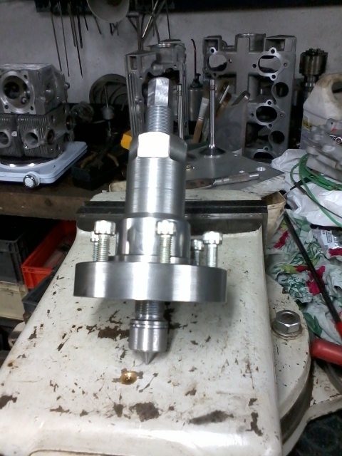

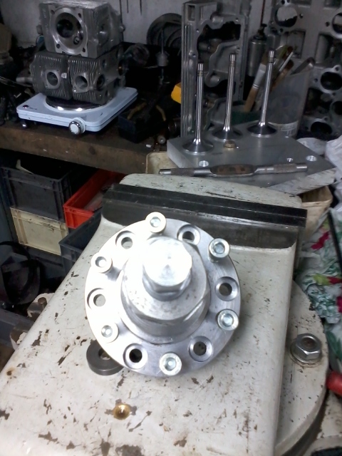

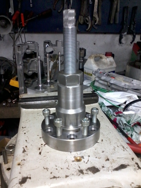

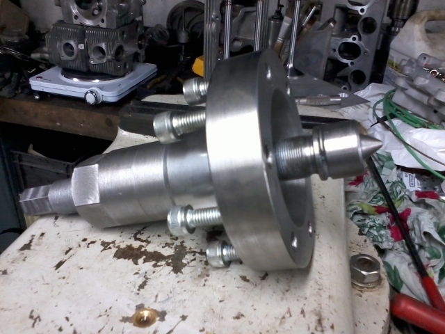

Every time I recoupled the crankshaft I tightened it to 27 mkg I always removed the toothed washer and glued the nut with Loctite 270 I generally fit the splines with silicone sealant, the engine which has more than 100000km has its splines in perfect condition, only once I reassembled it with Loctite 660 and for that I made an extractor in anticipation of dismantling, I had to heat it to around 100°C to extract it difficult with my extractor.

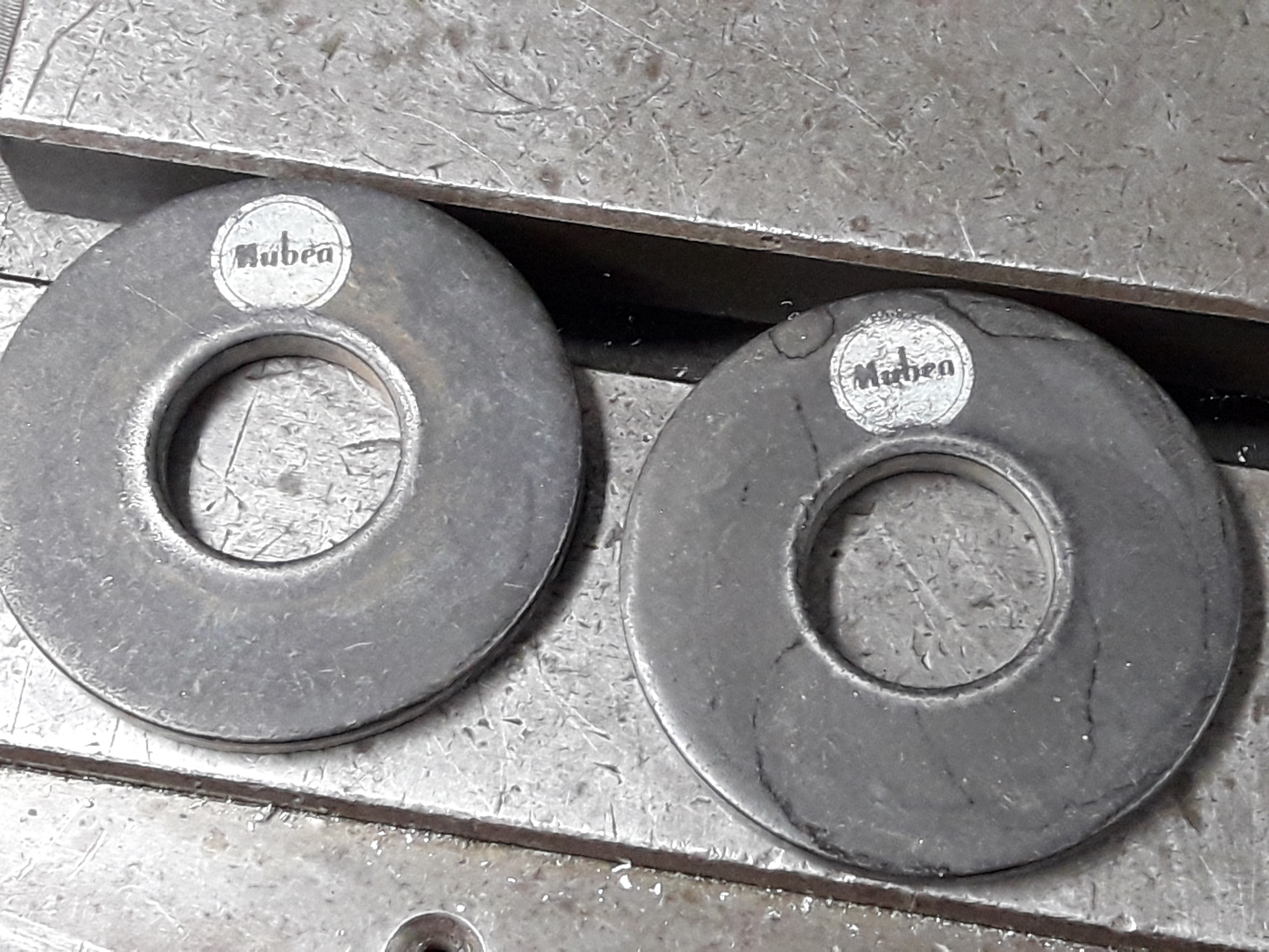

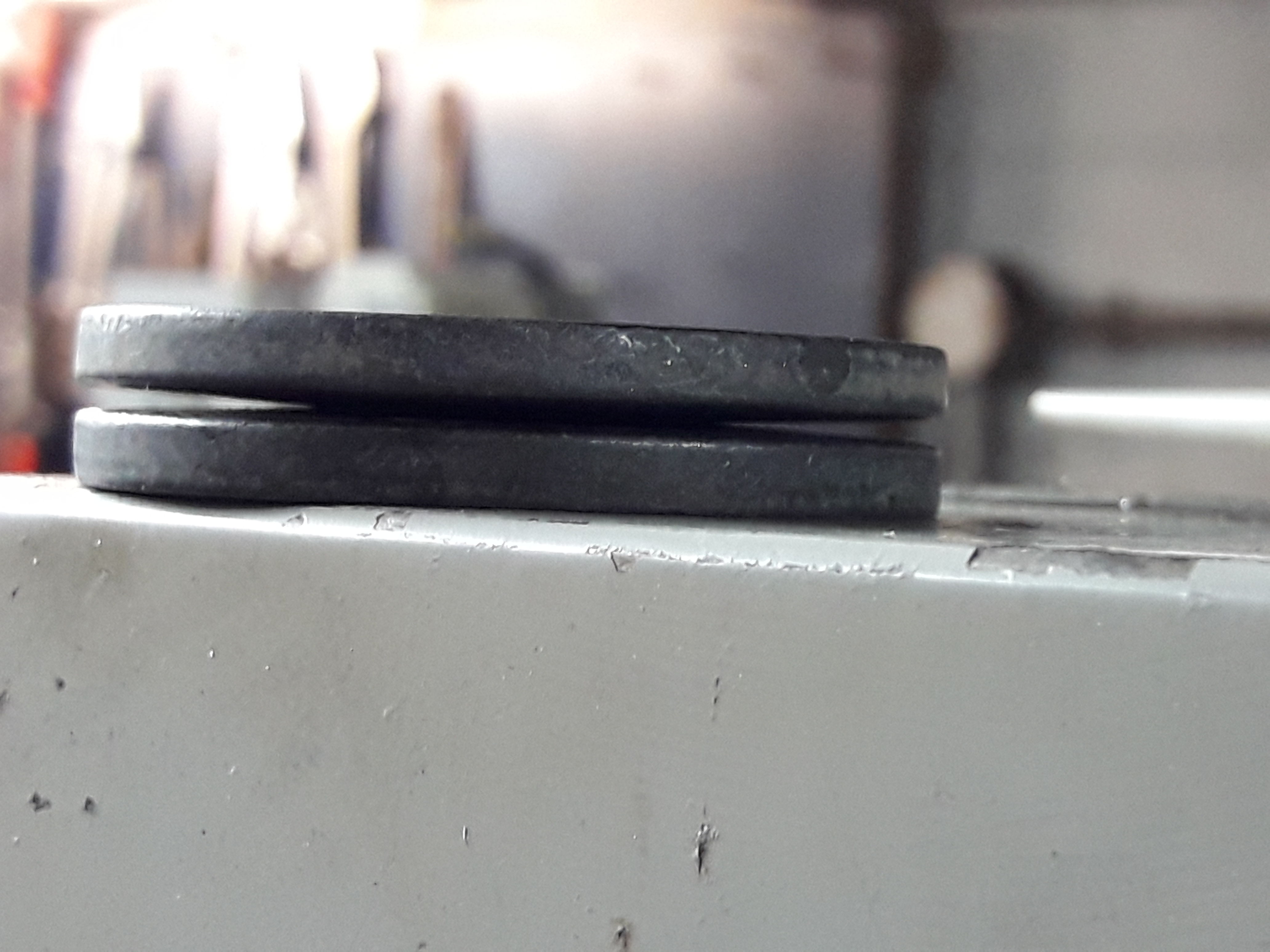

For a few years I have managed to find a Belleville conical spring washer with a thickness of no less than 3 mm to replace the flat washer and it seems perfect to me.

The data sheet for Loctite 660 says to heat the joint to 260c and disassemble.... possibly easier to say than do? The wire locking of the crank nut is a positive lock but it may still be pulled and break if there is enough movement I suppose, much like Wilson's Ralt. I would be tempted to use the 660 and improve the chances of it all staying together and worry about taking it apart if and when that happens. Nice puller GLLOQ !

After checking the thickness of the washer is 4 mm, I noticed that when tightening it takes at least 20 mkg to crush it flat, the washer is Mubea brand, I enlarged the washer internally to 7 /8 or 22.225 mm.

With this weather the rental price of the extractor has increased (two packs of light beers) or even more if the temperature rises. laugh2
