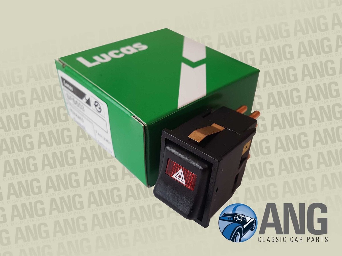

I believe the hazard switch is this one if it proves to be the cause of issue. Click for source.
Given the price just as easy to replace keeping old one for future repair and spare.
