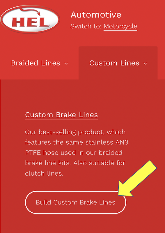

Thanks Rog. That HEL company is a real find. I found the website a bit overwhelming at first, but once I'd discovered the configurator, it was as easy as pie.
The standard plastic sleeving over the braiding which can be specified in a myriad of different colours is a bonus.
