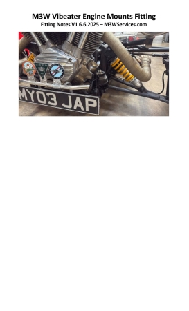

I just completed the installation of the M3W Services motor mounts. It's some work, but not too bad for us Morgan hands-on folks :-) I edited and expanded the instructions I received from Craig at M3W Services. I'd say the change is amazing - along the lines of the Ohlin's upgrade I did a few years back. The mirrors are actually somewhat useful now - who would have believed that!
In any event, here are my updated and illustrated install instructions - along with my approach to re-locating the regulator.
M3W Vibeater Engine Mounts Fitting

Completed project:
