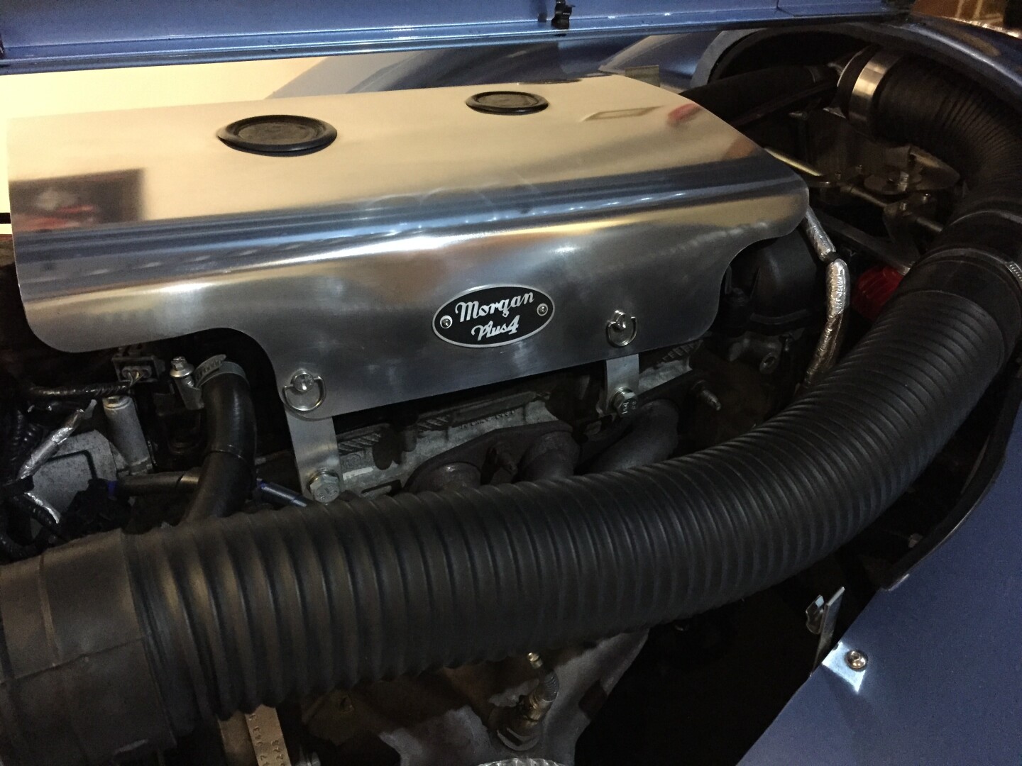

A functional cover can be home fabricated using aluminium sheet and a good few hours in the garage.
Since fitting mine over 5 years ago there have been no issues with water ingress around the spark plugs.
Chris

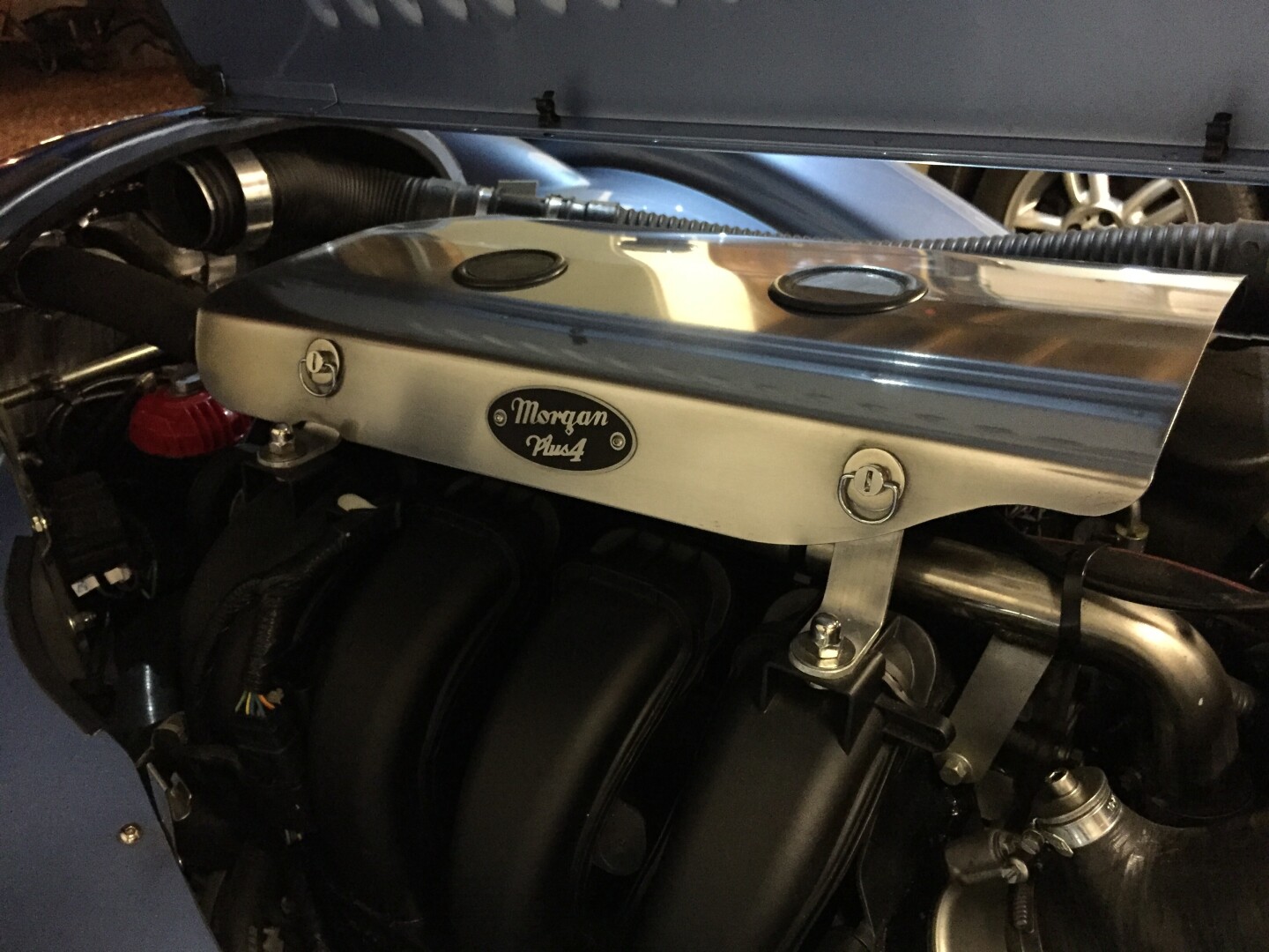

The finished article for the GDI - now sporting badges.
Chris
2015 Plus 4 Silverlake Blue
(2012 4/4 Sport Black)

Very elegant and seemingly practical too.... thumbs

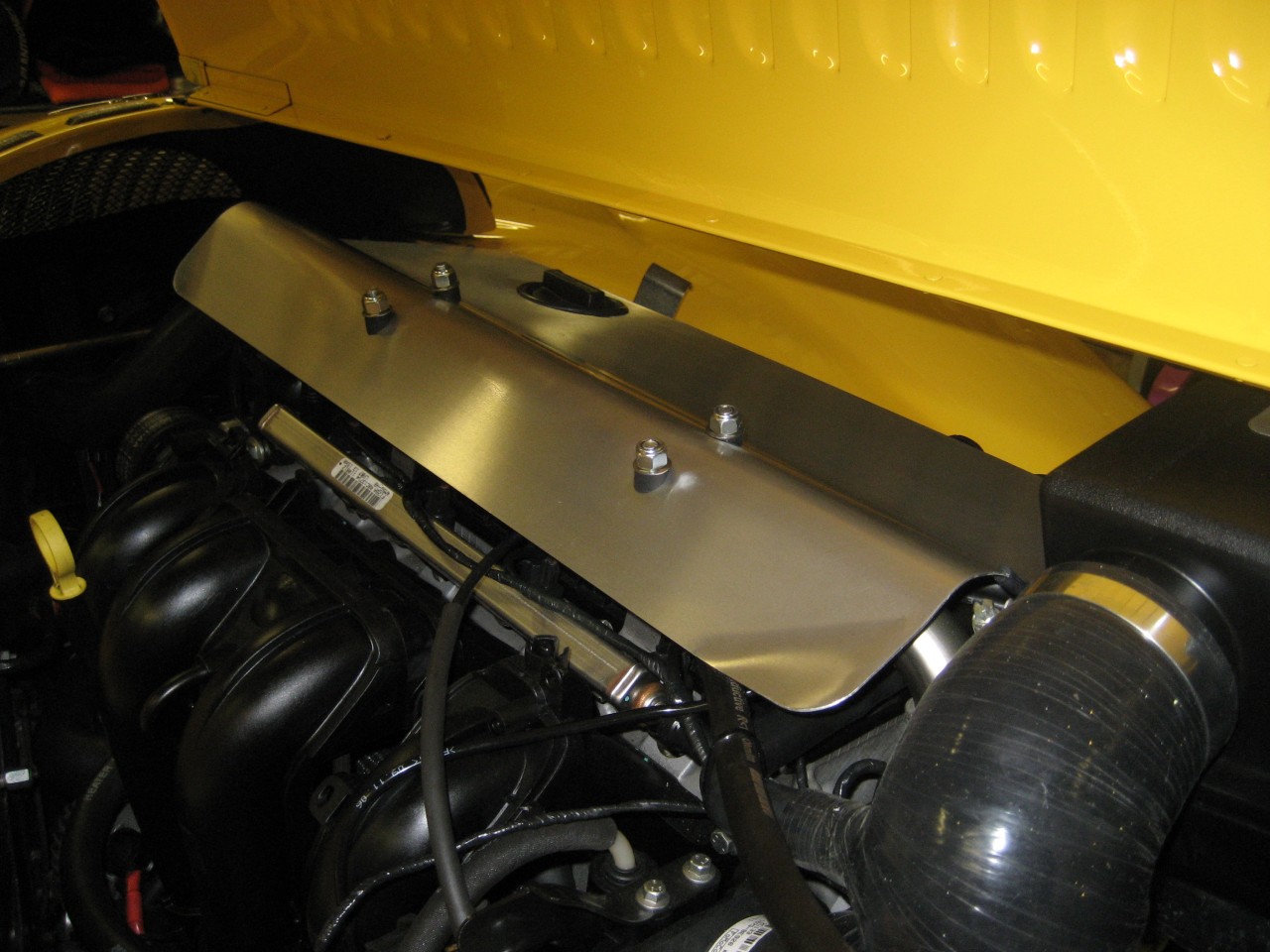

This was my Duratec cover. A simple aluminium plate contoured to fit works well.
And my GDI, now with a neoprene edge, but was just added in this image.
