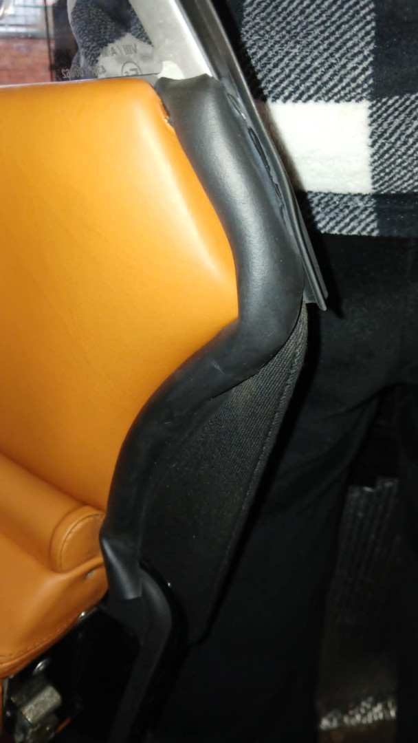

I have the same problems with the hood, there is a noticeable gap where the door seal finishes near the top of door/side screen. leaving quite a gap between the side screen rear edge, the top of the door and the hood. I got Morgan to replace that seal with a longer section and that has cured most of that gap/draught.

Thanks for your observations. Do you have any photos of the new seal that was replaced?
I would be very interested in the strap / velcro fix, if you take this further. I agree, it is inherent in the design of the frame hinge points. I don't see an elegant solution at the moment.

Its an easy DIY job, I was at Morgan having the service done and got them to do it whilst it was there, just need a suitable section of seal. You dont have to replace the entire seal, just add an extra section above where the current seal ends to achiieve the same effect.

John, thanks for the photo.
