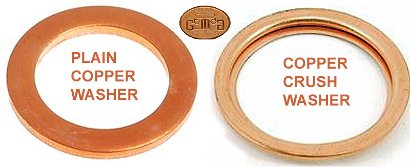

Who would have thought copper crush washers could be so interesting!
The aluminium 14.5mm ID ALU1403L washer is probably best used with an aluminium sump if you have concerns about galvanic corrosion.
The 16mm ID 213961 washer seems to be used for the 3.5lit Rover V8. You can also use 213961L or 213961A which is labeled a crush washer. These are all the same size and, not surprisingly, all look the same. However, they can also be 20/21mm ID!
Then we have ETC 7398 which is also 20/21 mm ID and seems to be associated with the petrol injection 3.9lit engines.
Confused? As far as part numbers are concerned it's a bit of a mess.
I think the answer is to make sure you have the same ID washer to hand as the one you took off, whatever the part number.
On the other hand RichardV6 probably has the best idea of buying a selection box.
To be on the safe side I've bought two ETC 7398 and a selection box. This should last me well past the time when I've forgotten I even owned a car! farmer
laugh2 Yes. The mechanic art form can get pretty picky! (aka anal)
For example, what you are buying and Richard's posted set are not, per se, crush washers. They are merely plain copper washers. They are designed differently. I use them for spacers, for which they are ideal.
Here is what google says verbatim to a question of "crush copper washers versus copper washers".
"Copper [b]crush washers are designed to plastically deform (aka squish) under pressure to create a
high-integrity, leak-proof seal for, say, oil drains or high-pressure lines. Standard, solid flat copper washers serve
primarily as spacers or static, low-pressure seals, merely distributing load rather than deforming to fill gaps" [/b]
This little bit reflects my experience with the sump you and I use. Rimmer and other specialist sell crush washers specifically for your Morgan under their part number 213961a which replaced the original 21396, one of the original numbers for the correct washer . https://rimmerbros.com/Item--i-213961A However, as the French say, "Chacun à son goût". And little leaking at the sump plug is something that can be tolerated by most people 'cept the odd nutter like me and Concours players. Manufacturers, change these little thingies as costs change. https://www.macrotrends.net/1476/copper-prices-historical-chart-data Economists call it "hidden inflation".. namely holding the product price steady but degrading product quality It has become the most common expression of inflation for the last few decades. Manufacturers know that inflation is politically unpopular and have adjusted accordingly. Rimmer also sells plain copper washers. I show both types below. The difference, in layman's language, is that the plain copper washer, in this usage, will not deform as much to compensate as much for anomalies specific to your sump and plug.
Lorne
