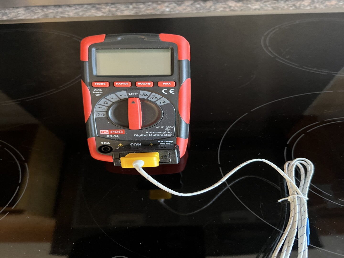

This wee R/S auto ranging meter with thermocouple is the one I use on the cars though and £30 you can’t go wrong.

They are romantic things but too cumbersome and liable to cause damage working on the Morgan’s and the thermocouple is a handy feature on the RS one.
