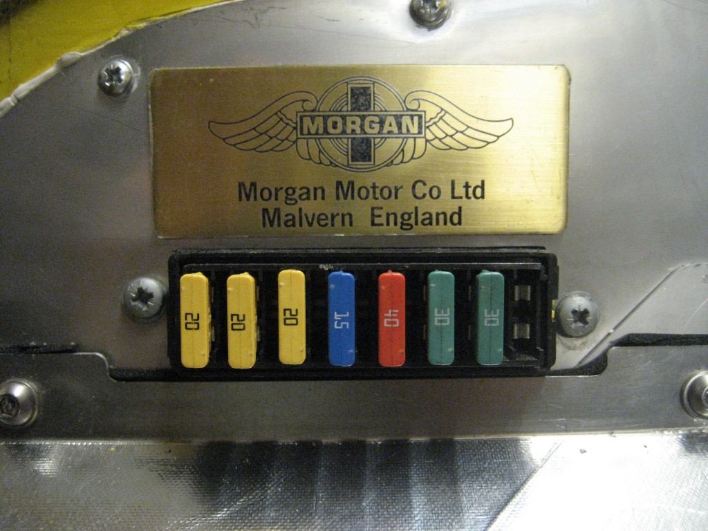

So - first with the engine running I checked the bulkhead fuse box. The fuse which cuts the power when running is 30A second from the right. (Ignore the empty space).

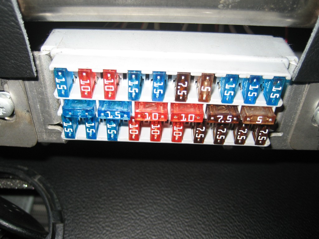

I repeated this under the dash with the secondary board.
Two fuses cut the ignition power, both 15A and in this photo, upper row and second/third from the right.

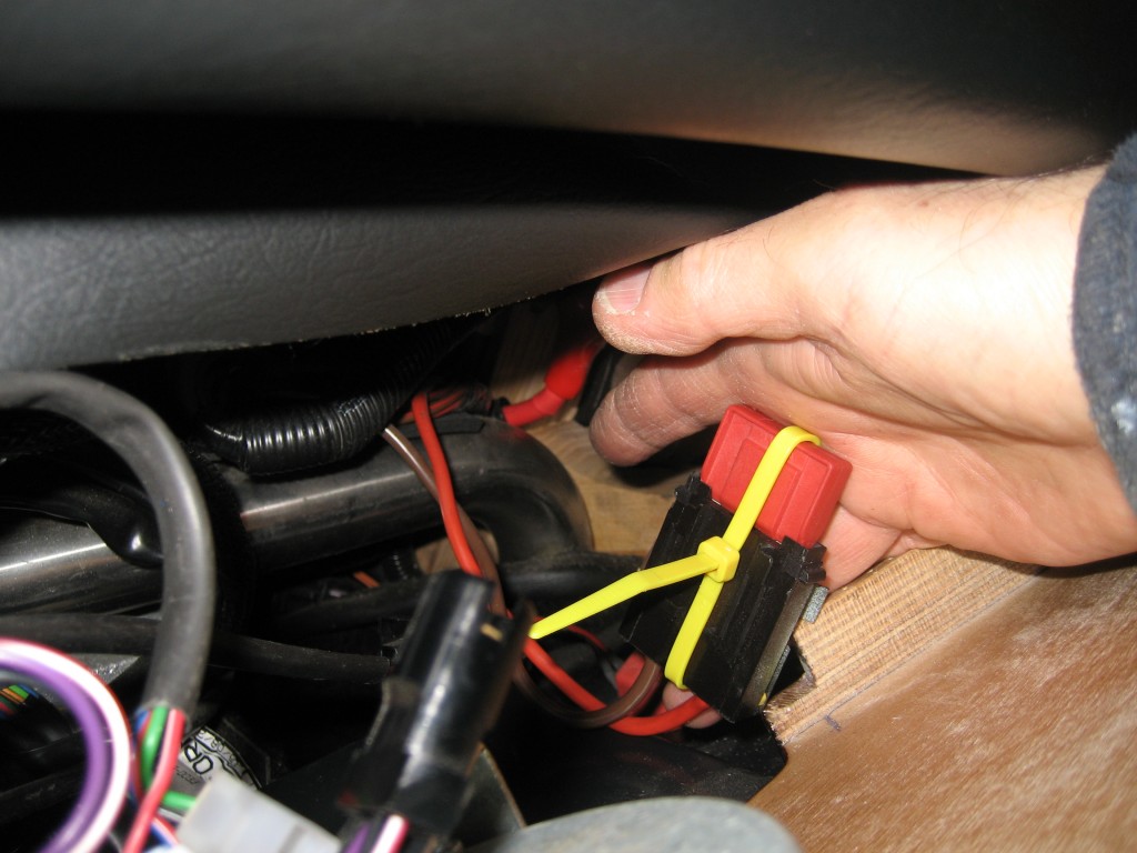

I checked all the fuses with a torch and a waggle and all were intact. I then went behind the dash and with the engine running, did a lot of waggling and pulling, but could not replicate the cough. At this point I placed a neoprene buffer across the top of the steering column, because where the column swivels, there are two springs and the wiring loom is in contact with some hard edges. Finally I checked out the second main fuse. This is like the one next to the battery but 50A and shoved loosely in the corner. It wasn't pushed fully home, so I cleaned the contacts and fitted a cable tie in matching yellow.

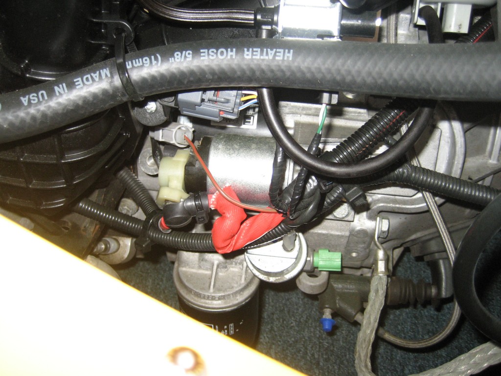

This was the place:
The red wire looks uncomfortable anyway, but was previously held tight in the S shape by a cable tie. I suspected a break in the cable but it appears not to be the case. I've also added a rubber cover because the solenoid 12v live feed stud is exposed there. What's also interesting is that the thin almost vertical wire which is white and green at the top, was making a bad connection and it may have been this one which was the problem. I can move it around now and there's no cough so unless it recurs later, that was it.
