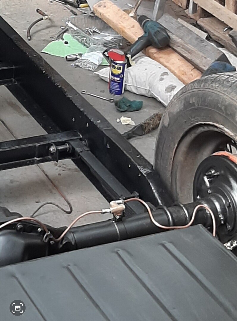

Logg .... here's mine with T-piece ... during the resto, so all sat in place waiting to be connected up .... guessing yours has been PO modified!

My .'72 is the same as above with a T piece, but in my vague collection of memories, I'm sure I've seen a set up like yours with a hard link pipe between rear cylinders. so it may be a factory fit.

I have seen early cars plumbed in with both methods from MMC.
The T-piece is a better system for bleeding , but both will work well, especially if you have a "power bleeder" .
If it worries you , then plumb in a T-piece , but if not continue to drive on your current system and make a note to convert it when you do a rebuild , or other major work.

Thanks to all for the info - I've never seen a series connection from cylinder to cylinder but can power bleed for now. A "T" and new lines over the axle go on the "list", but not at the very top. Logg
