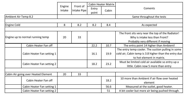

Looking at 2 Mods this winter.
1. Heat Shielding the Air intake
2. Adding a Shutoff or Bypass to the Heater Matrix.
So thought I'd take some measurements before starting to confirm they are required and use as a baseline for comparison later.
Took the measurements today and thought I'd share the results.
This was done with the Car NOT moving simulating being stuck in traffic. I purchased 3x Temp Sensors to measure different points apart from the Engine Intake which is from OBDII.
The Cabin is coolest if you never use the Heater Fan and air never goes via the hot element, I'll even make sure the vents are closed..
The heater Matrix adds 4 to 5 degrees to the air temperature.
The Air into the Cabin is 12-15 degrees more than Ambient.
The Heater Matrix entry gets quite Hot compared to Ambient.
There is a gap in the foam, that goes round the Heater Matrix entry, at the front where the hot engine bay air could get in, I think I'll fix that 1st and re-run test. If that can be improved a heater shutoff/bypass will be next but there's no point if I can't reduce the entry temp.
Have shelved the Air Intake heat shielding for now, might be better to find a cooler location for the front of the pipe. Also need to do the test while driving.

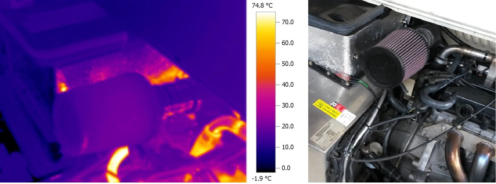

On a differnt theme, thought the pic below may be of interest showing the temp of my old 1.8 heater matrix enclosure. I snapped this with a thermal camera after thrashing the car, stopping and quickly lifting the bonnet to record the intake temp.
The ambient temp at the time was 17/18C.
Have fun with your mods thumbs

Thanks All, turned out to be a more interesting discussion than I thought it would be.
JohnV6 - Saw your post and I intend to do the same and re run the test.
Rog - That thermal image shows the very hot pipe that feeds the heater matrix, although not the same engine I think it's highly likely mine is the same. Hadn't thought of discarding the Intake Box but have seen another thread where someone has fitted the filter just in front of the throttle body on the left (cooler) side of the engine bay.
RichardV6 - interesting taking air from the bonnet side vents, food for thought.
gomog - you are correct in assuming the car was not moving and I was IN the car. I did put the top down as the interior was 2 degrees warmer than Ambient when I got in.
Montegue - Interesting you and Rog both placed the air filter high at the back of the engine.
I'll need to take some temp readings from possible air intake locations in the engine bay while driving to see where best to take air from. Agree that Intake temps at Idle aren't relevant so will have to figure out how to monitor on the go, it may be that where its currently located is ok when on the move.
