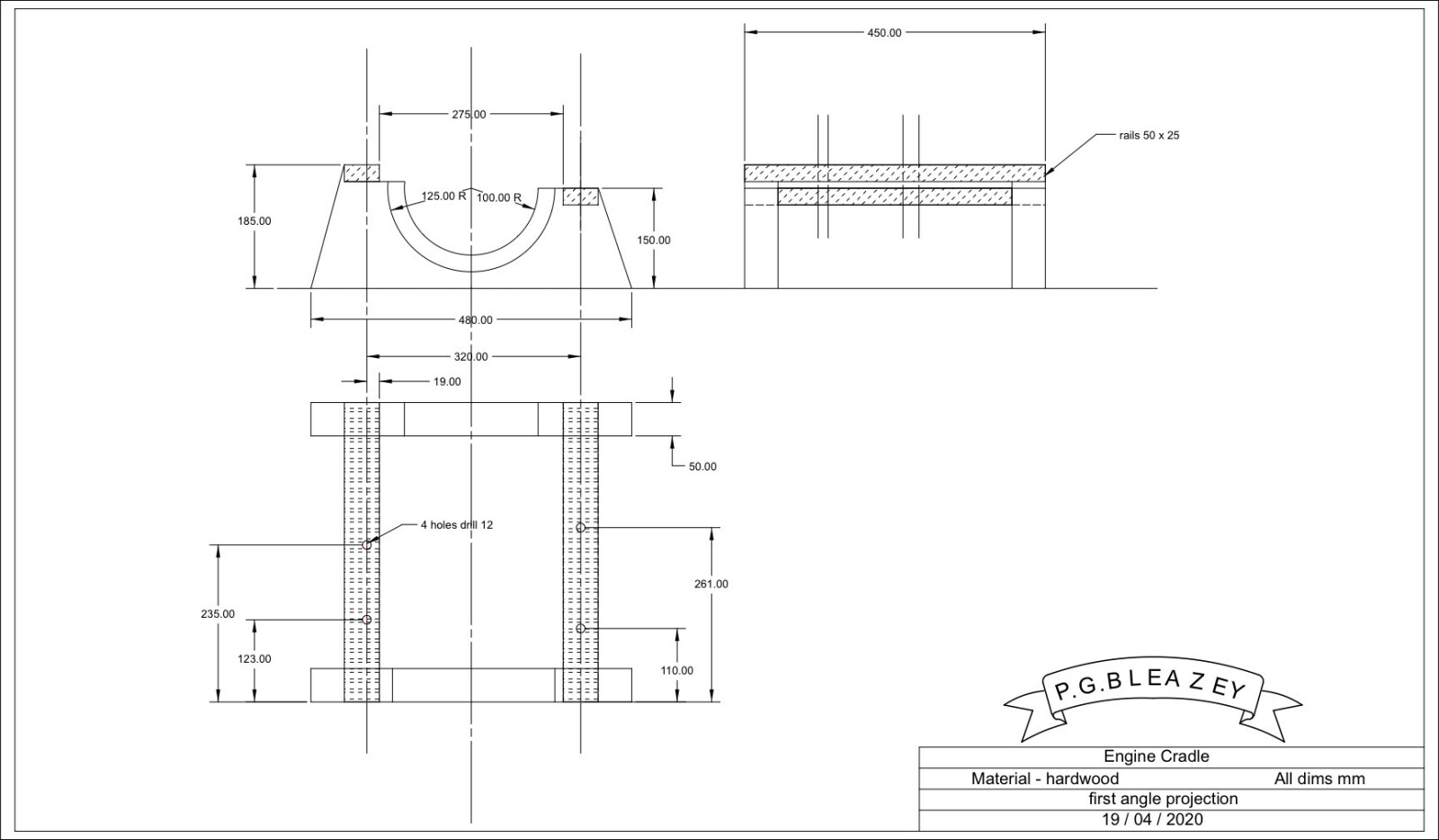

Does anyone have drawings or diagrams of the following:
1. S&S Engine Stand 53-0147 - To build a stand for an **S&S X-Wedge 121 engine**, you must use the **four mounting points on the lower cases** and a **top support brace** connecting the cylinder heads.
2. **top support brace** connecting the cylinder heads for lifting with a hoist. The S&S manual specifies that the top support brace must connect the **3/8”-16 tapped bolt holes** located on top of each cylinder head above the intake port using **7/16” Grade 8 bolts**.

This is a drawing Bleazey sent me when I asked him. I ended up buying the S&S engine stand.

Socalm3w - thank you so much for this!!!! Another true example of the Bleazey genius at work. Does anyone know if Phil also had a drawing of the top support brace?

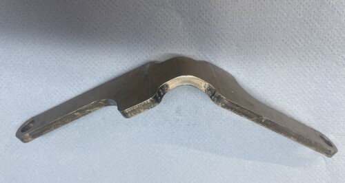

All the X-Wedge engines supplied to Morgan were fitted with a lifting bracket, Morgan removed them and threw them in a scrap box. I was fortunate to get one when I was on a visit to the factory once. It's been used a few times since!

Not being an engineer myself, is there a way to scan it for dimensions?

I cannot take the credit for the engine stand, just the engine sling bracket....that you didn't use 😁. Good luck with all the work. Always good to see owners working on their cars.
