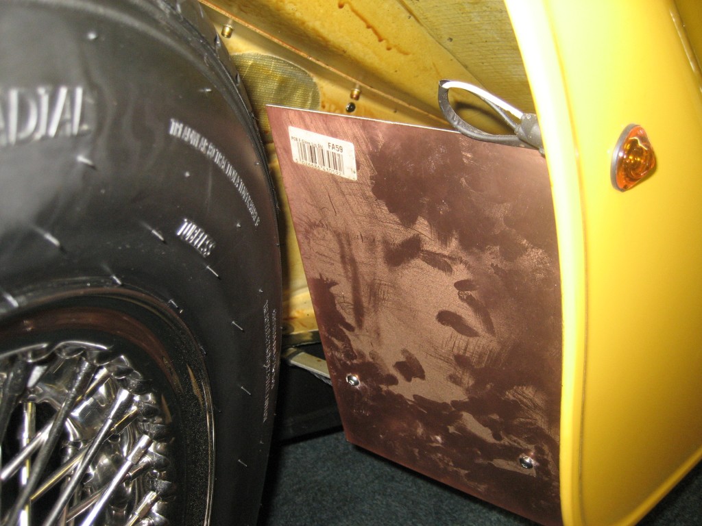

Anyway - over the weekend I added the front wing protectors.

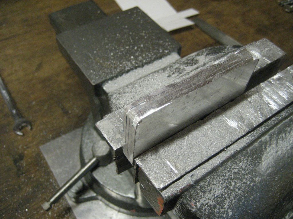

Four brackets made up from 2mm aluminium. I had a conveniently shaped offcut which saved some time.

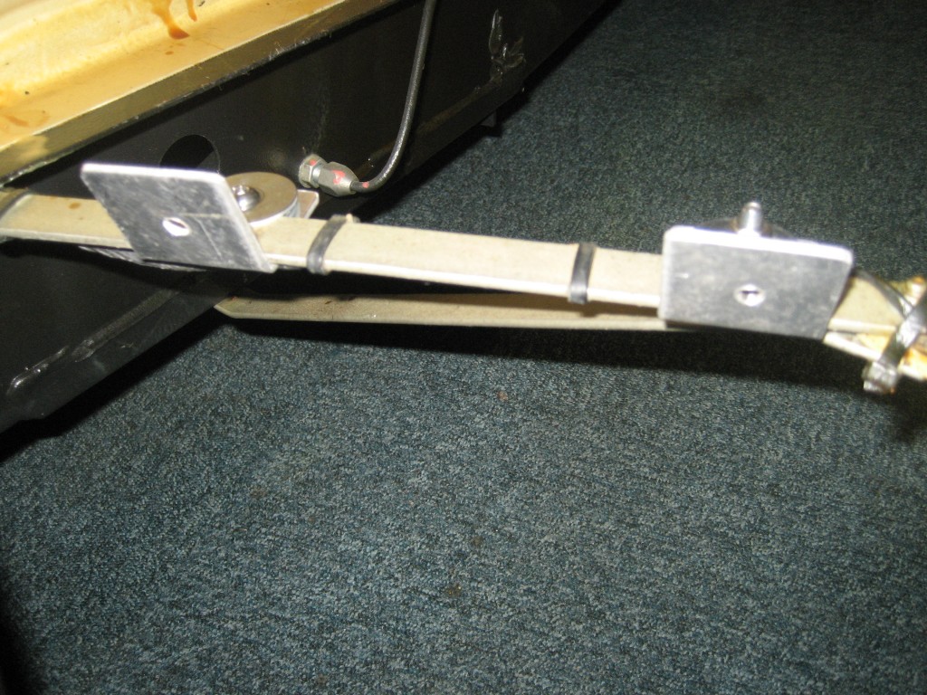

These attach to the front wing stays with stepped penny washers.

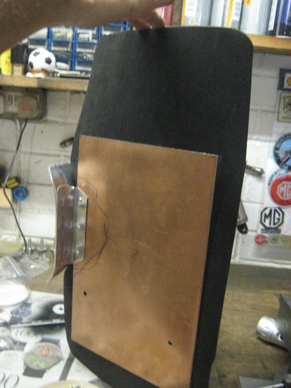

Trial fit of the Maplins circuit board.

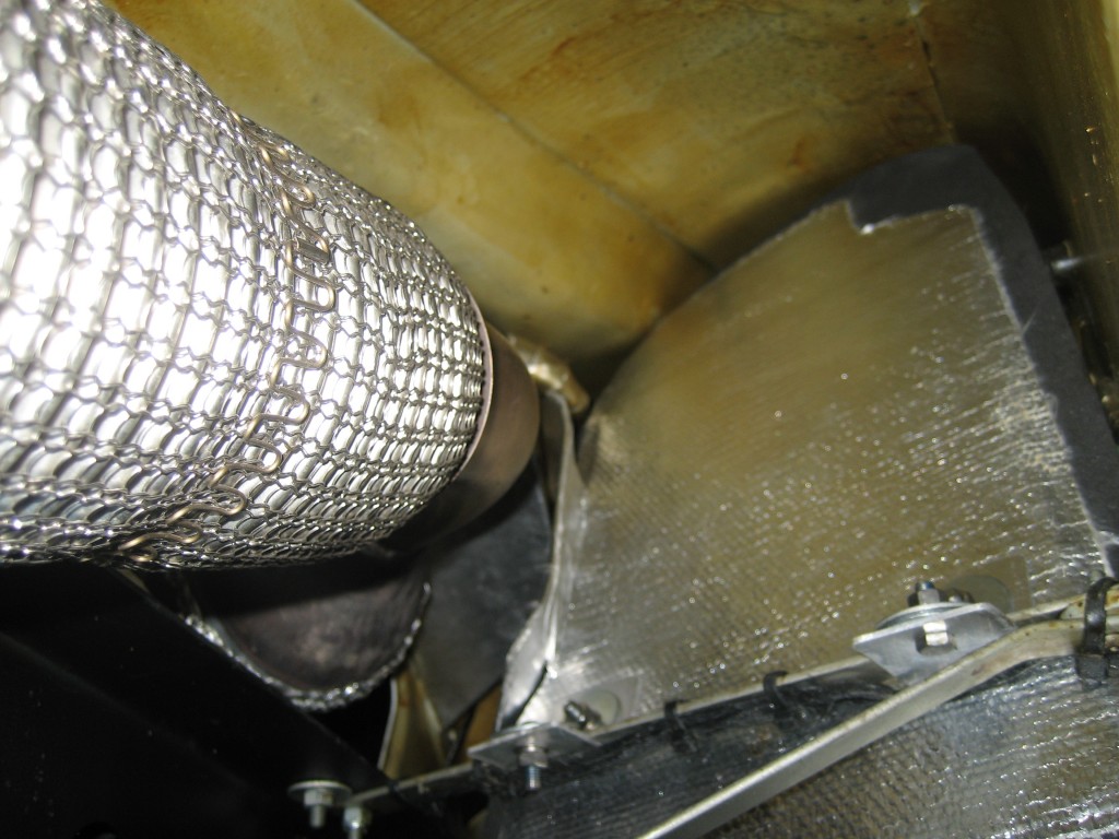

On the offside, it needs a temperature barrier, so this was the result.
At the back I lined this with reflective foil.
So that's as much as I can do for wing protection. The lower part of the rear wings are very vulnerable to starring, but the flaps would have to be really low to cover the lower part of the wings, so you take your chances!
