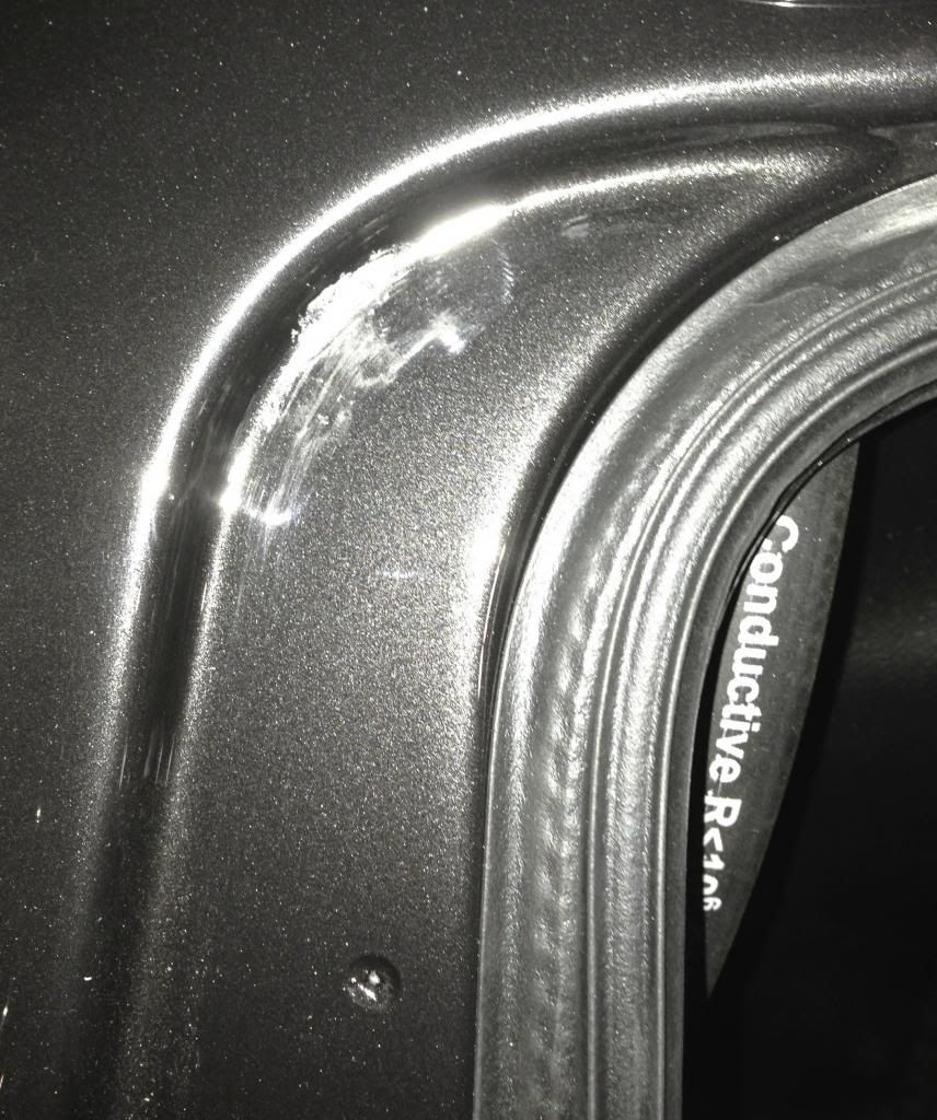

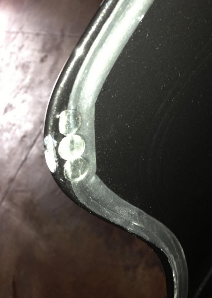

Boot Lid Weather Stripping
the weather stripping was improperly installed so that at a certain point on the boot lid there's not enough cushioning so that when it's closed it rubs against the painted body thus wearing off the paint on both the boot lid and the body where they come in contact. This issue was there from the day we picked the car up at the airport in the states. I've since had to put rubber adhesive furnitures pads on the boot lid so it doesn't keep rubbing more paint off. Have still not gotten a proper response to the issue from morgan or my dealer. Below are a couple pictures for reference

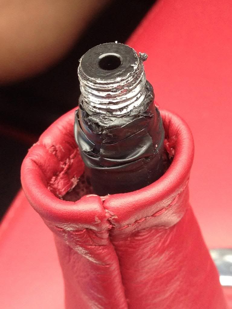

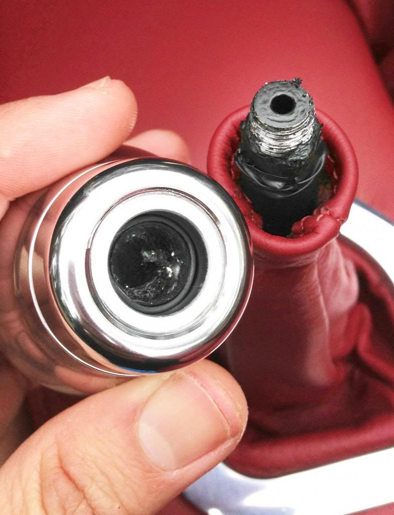

Shift Knob
only a week in to ownership and my shift knob went from being solidly on the gear lever to feeling wobbly and hardly attached. this morning i unscrewed the knob to see how it was attached and found the threads where beaten up and when trying to put it back on there isn't a point where to knob screws on tight, just spins and wobbles continuously. Below are a few pics from this morning as well as a quick video of the issue from before i unscrewed the knob
