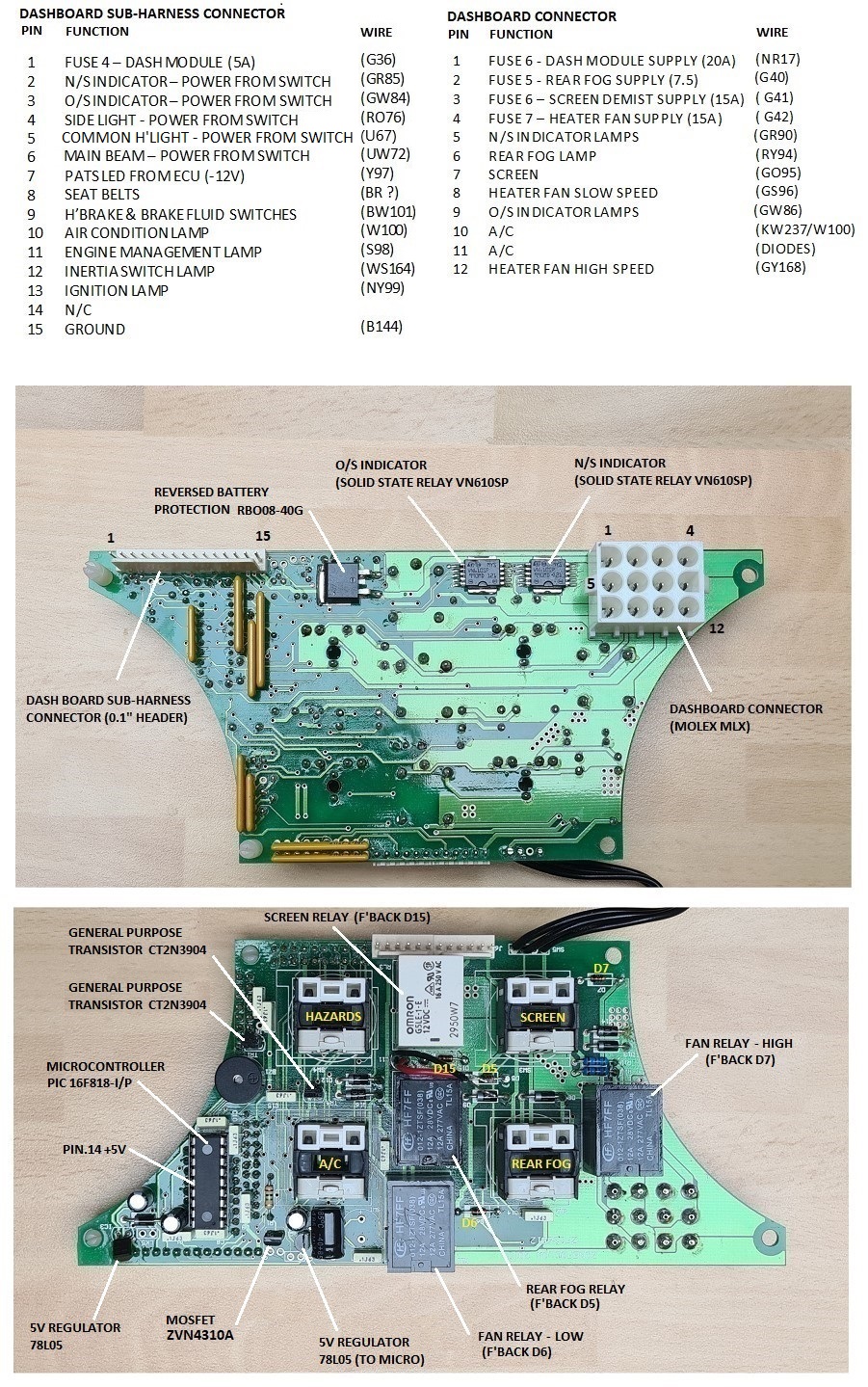

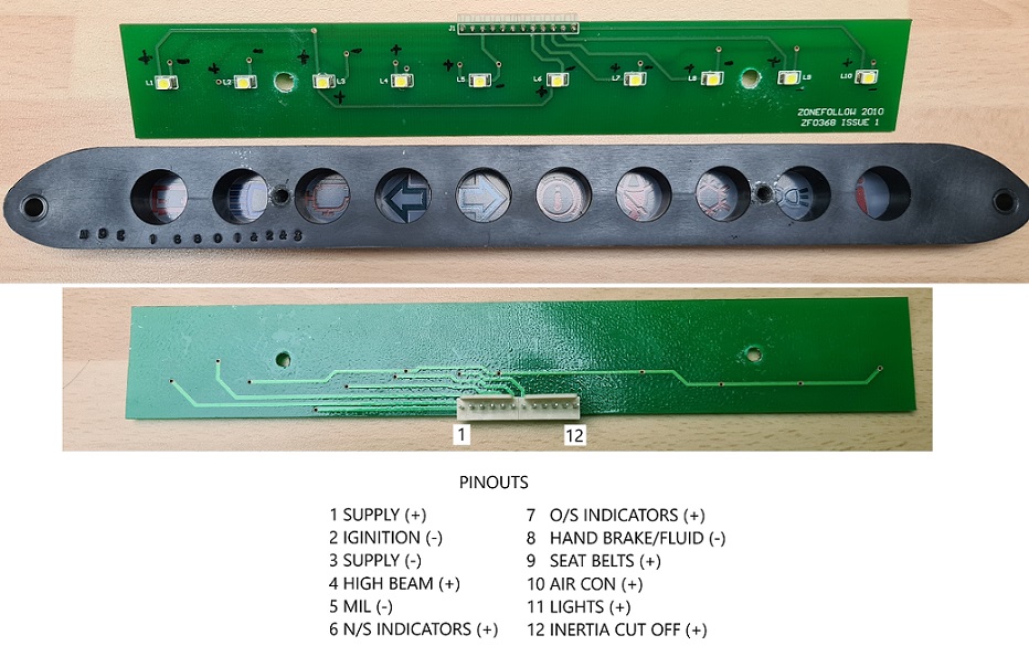

The pcb connector pinouts might be useful too. Again this is only my stab so use with caution….
Dashboard PCB
Warning light PCB
Hope it helps somebody....
Roger
