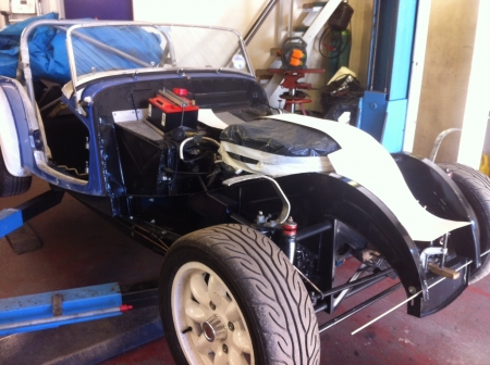

This weekend saw the fist fit of the front wings.. in the last update we left the sprint car with the inner bay panels fitted as a rolling body.
Now it's time for the new front wings to be trimmed and fitted.. it is one of those measure, measure, measure...... measure.............measure.................cut type of jobs..

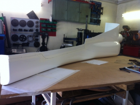

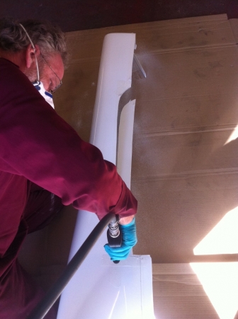

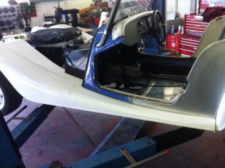

So templates, tape measures, squares at the ready... we started on the O/S wing making a template and marking out a trim-line.

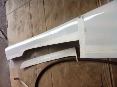

Finally after a lot of drawing, measuring, holding it up and comparing.... finally we're ready to make first cut. For this we decided to use an air saw rather than the rotary cutter we used last time. The air saw we have found provides an ideal combination of longer distance straight cutting and short curves in a way an electric jigsaw or rotary cutter allows. Using a metal cutting blade also allows a fine cut. The air saw cutting speed also seems to be slow-enough not to "gum up" the blade.
yes - we are using fibreglass wings - before anyone shouts heresy - many cant tell without touching and tbh... rubbing is racing and wings are the on the front line of the action.

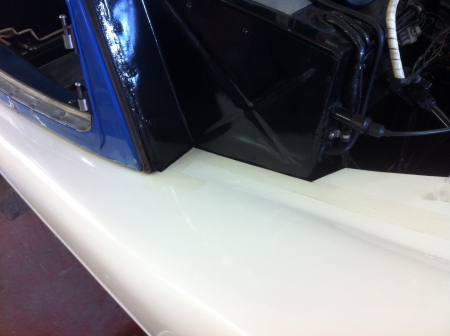

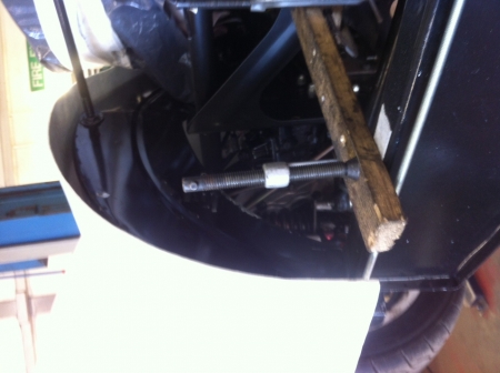

We only trim upto the end of the bulkhead as we will trace the inner bay panel shape on the inside of the wing to get the cut line perfect.

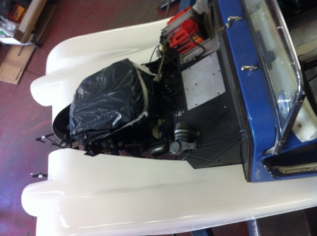

The first fit shows that the template and measurements were just where we wanted them. The fit is tight and accurate all the way along the body-line.

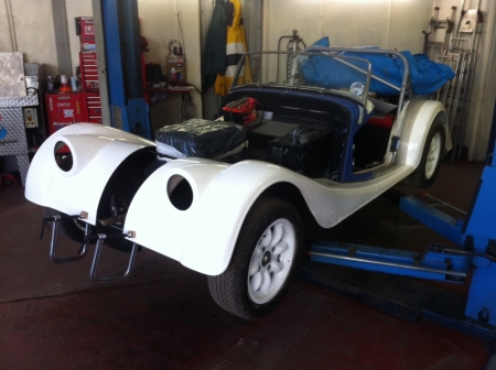

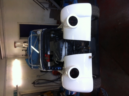

Now onto the N/S, as you need to get both on before final trim to get them aligned at the front end otherwise you have little room for adjustments if they don't both line up perfectly... which given the hand made nature of the Morgan front end - is "rarely".

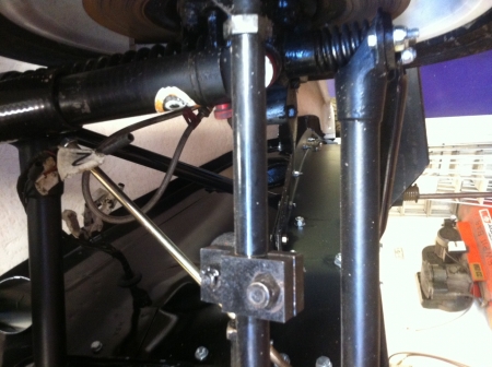

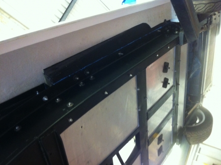

You can see that on first fit the inner lower edges of the wings are not on the same plane a variety of adjustments to the inner wing brackets and the bay panels is required to get them into the perfect position... we're only talking a few mm but it's obvious when you see it.

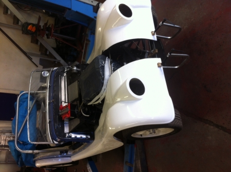

Following small adjustments we get them aligned.
The gap lines on both sides are tight and the wing visuals on both sides looks uniform and symmetric (although they are actually not quite - this is normal before anyone asks).

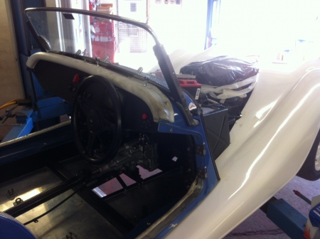

View from the gallery (sorry it's slightly blurred)....

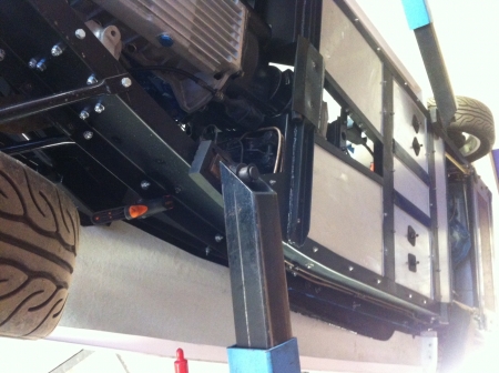

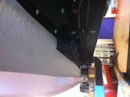

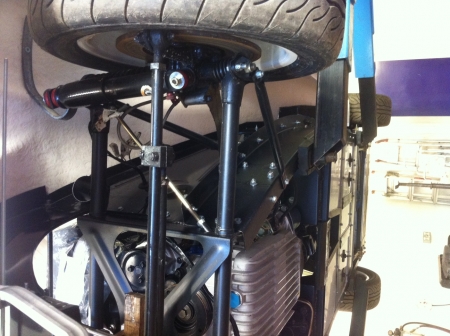

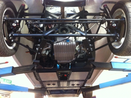

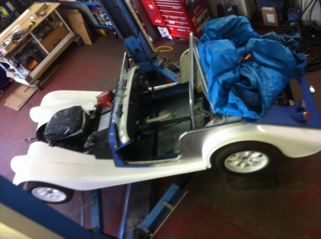

From underneath... it's one super shiny car....
