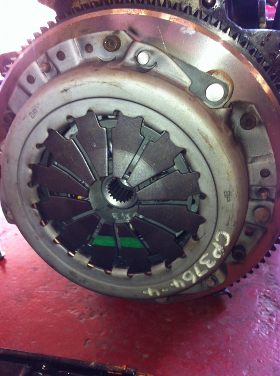

It's clear that it's one high performance xflow and in very good condition....!
With the engine and gearbox stripped out we were also able to compare the Type "E" Rocket Box prop shaft with a spare Type 9 box we had lying around. We quickly realised that whilst the length of the prop was fine the output shafts of the two gearboxes were different in size and we need to sort out a new Input female splined socket on the front of the prop or a new prop (research into this will commence immediately). We have a supplier who can probably sort us.. but it will be interesting to see what others have done.

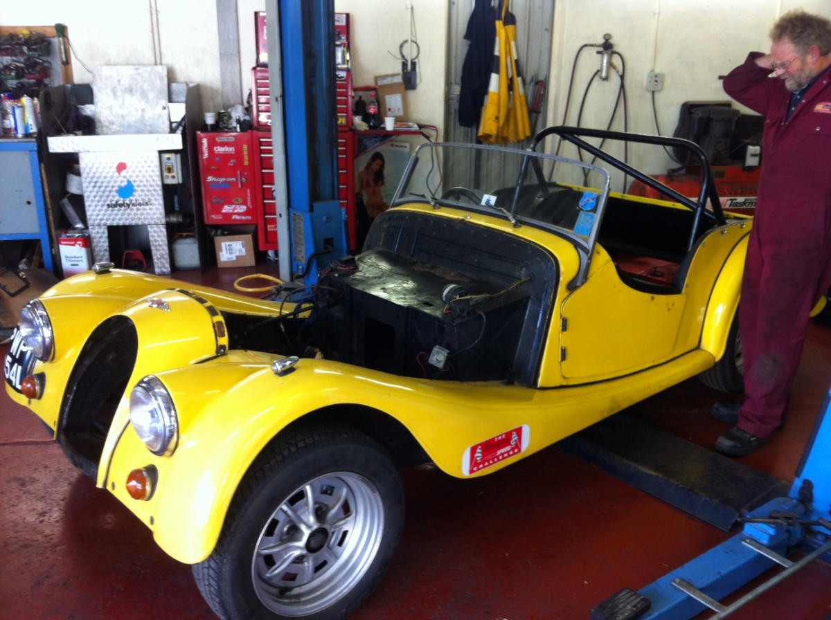

So at the end of the day...
Almost at the point of starting to clean things up.... just the wings to come off.
