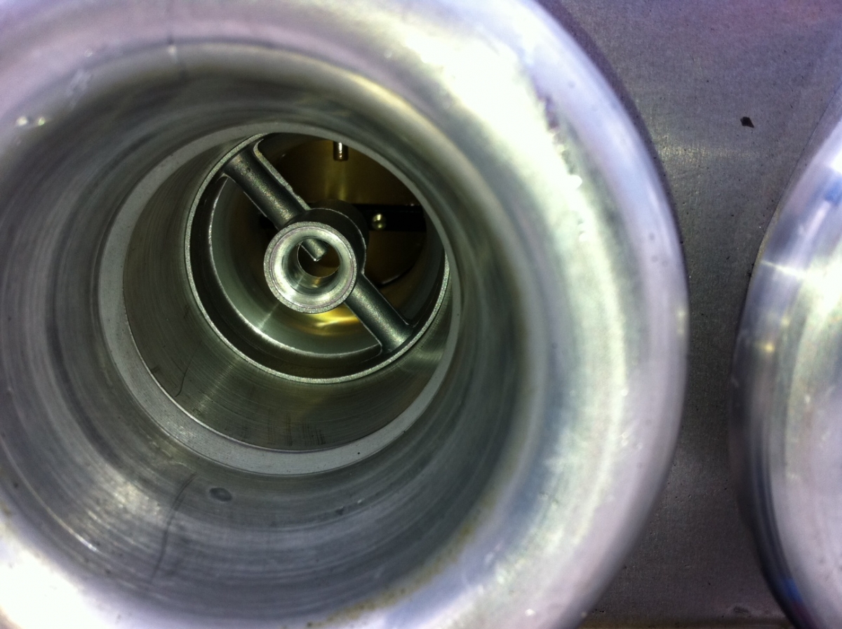

This is what the carb should look like

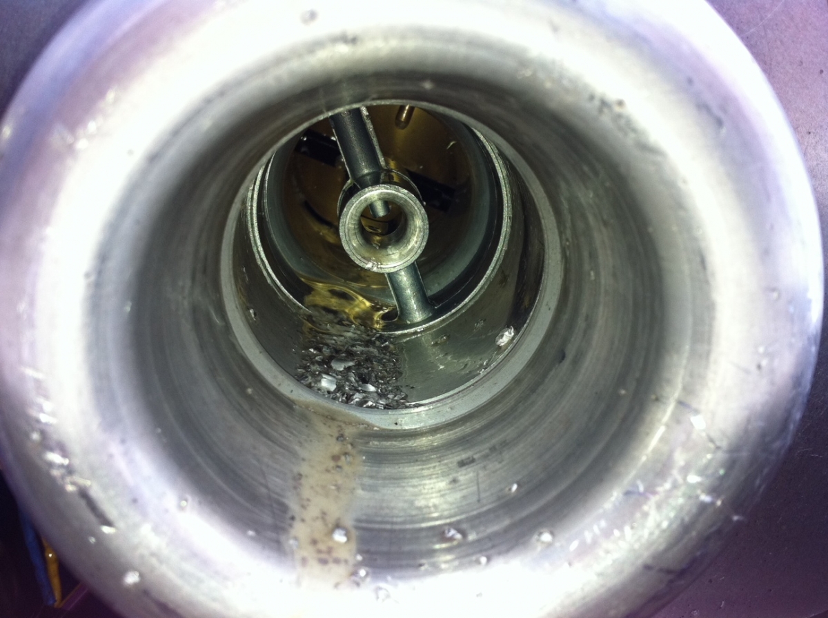

The shavings you can see in this picture are bits of piston that have been expelled back through the carbs.

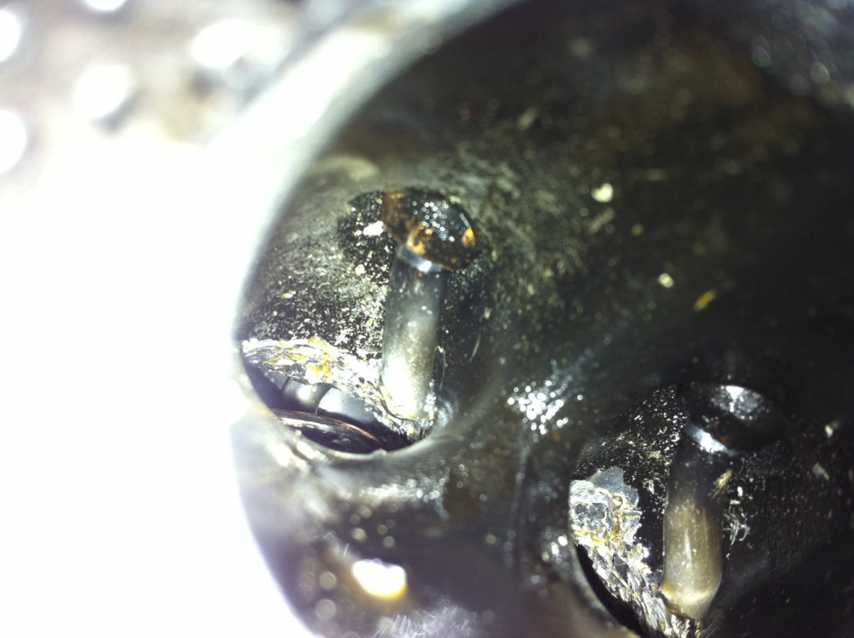

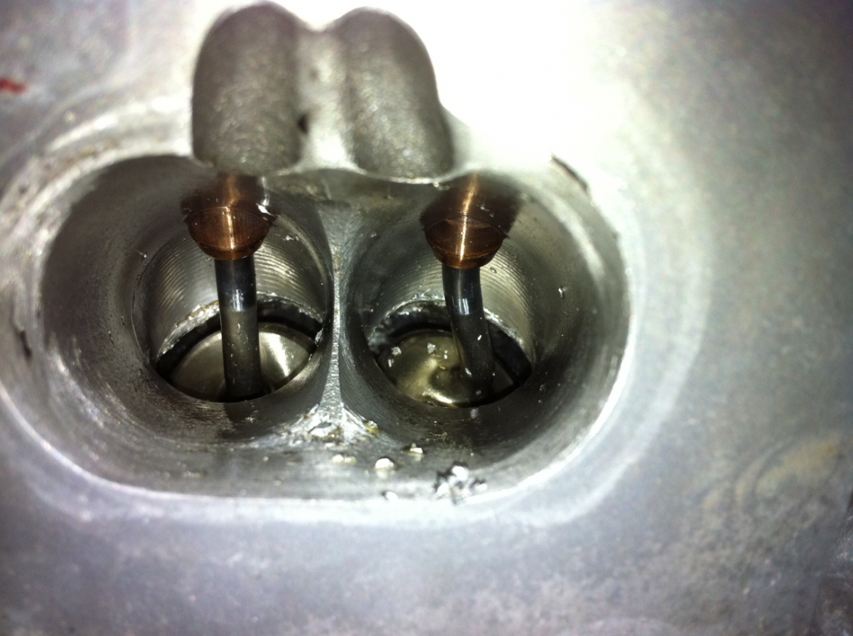

Taking the engine out today, you can see some of the damage in Cylinder 1 inlet - the valve stem is bent.
In the exhaust port things are a little more serious.. they valve heads are snapped off and completely destroyed.
