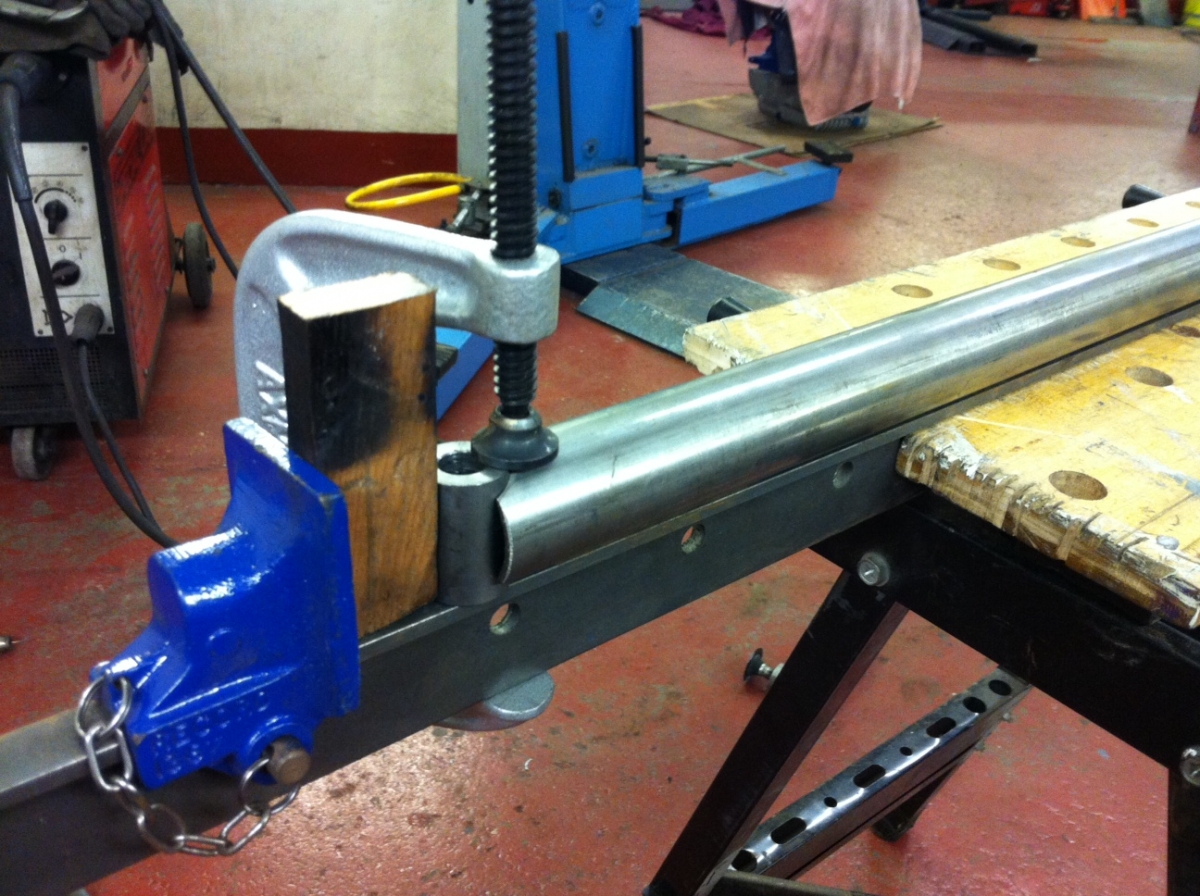

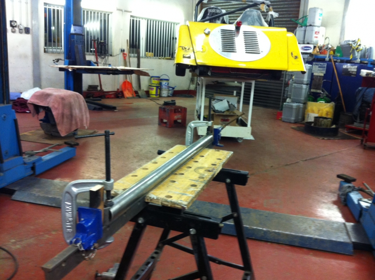

The challenge with making the door bars was to be drilling out the large circular slots for the bracket barrels to be welded into... getting both in the same plane (or upright) at both ends..... You can see the challenge in this pic.

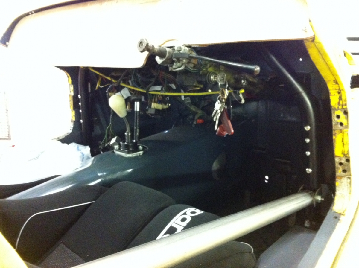

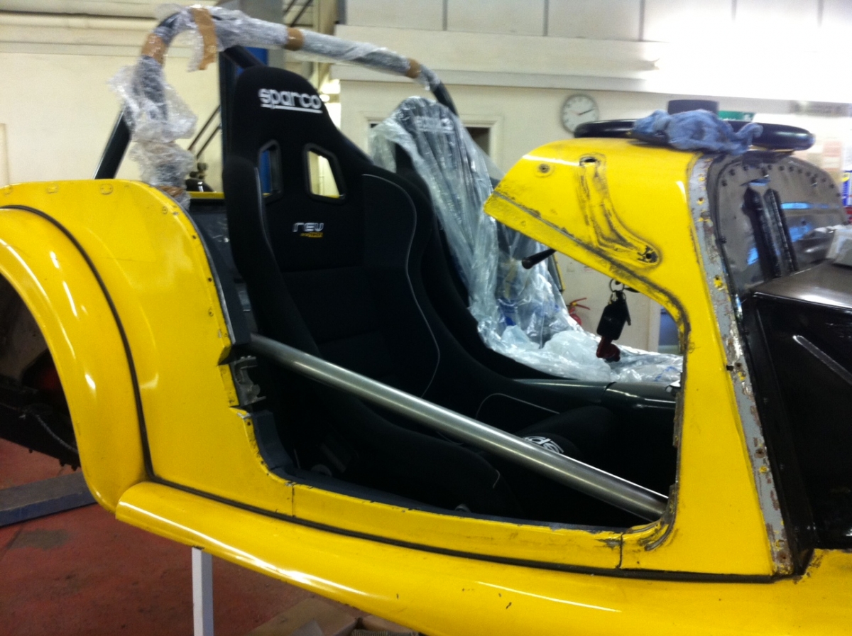

We successfully managed to get them sorted though and managed to fabricate and fit the door-bars yesterday. They are now packaged up ready to go to the powerder coater along with the black harness bar.

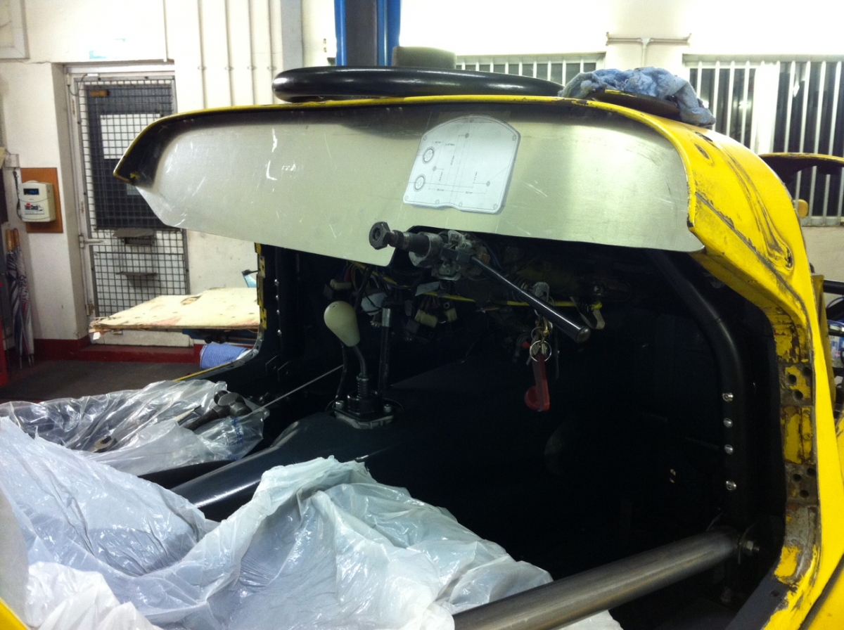

Woodstock is going to have a similar dash to the blue and white car. The original instruments will be ditched in favour of the Race Technology Dash 2 with a DL1 GPS Data Logger in conjunction with a basic sensor package and Omex ECU feed.
We had already made a wooden dash blank template and yesterday this was converted into an aluminium blank which will be machined up to be a new dash. Black Carbon Finish vinyl will again be used. It's likely that the dash buttons this time will be completely changed for smarter aluminium units.
