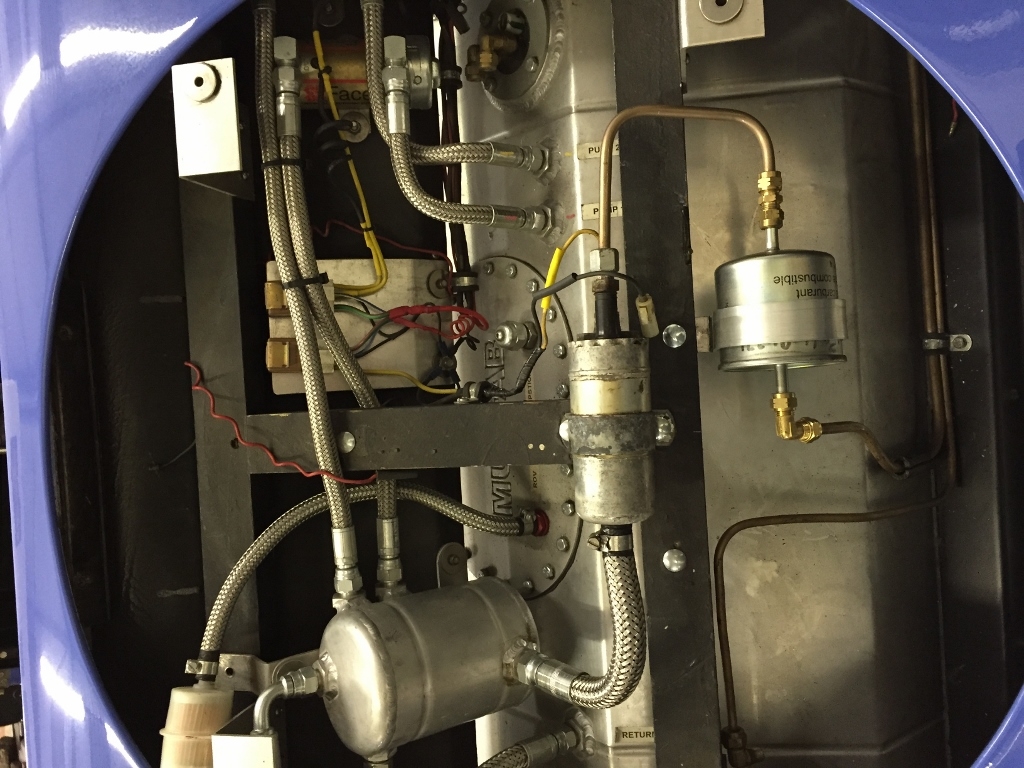

Job 1) at the back of the car, we can leave the lift pumps feeding the swirl pot as they are but the fuel delivery pump which sends fuel to the front of the car needs to be changed for a high pressure unit. Additionally we need a filter suitable for a high pressure system.

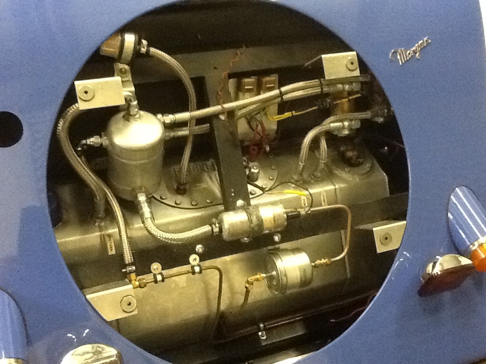

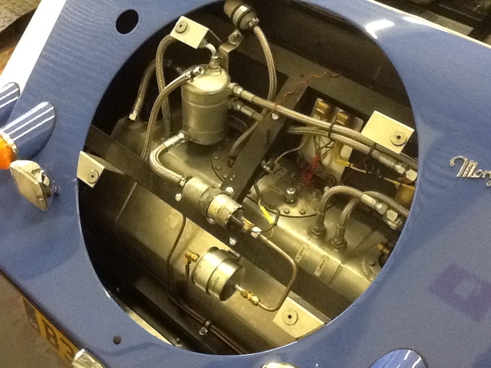

This is the old set-up, you can see the low pressure feed pump along with the blanked off return pipe waiting to be used.
We have a couple of Bosh high pressure fuel pumps so lets get the old Facet unit out and see what mounting options we have.The position below looks favourable. We'll keep the Facet unit as a spare for the lift pumps if they fail and also for Woodstock.

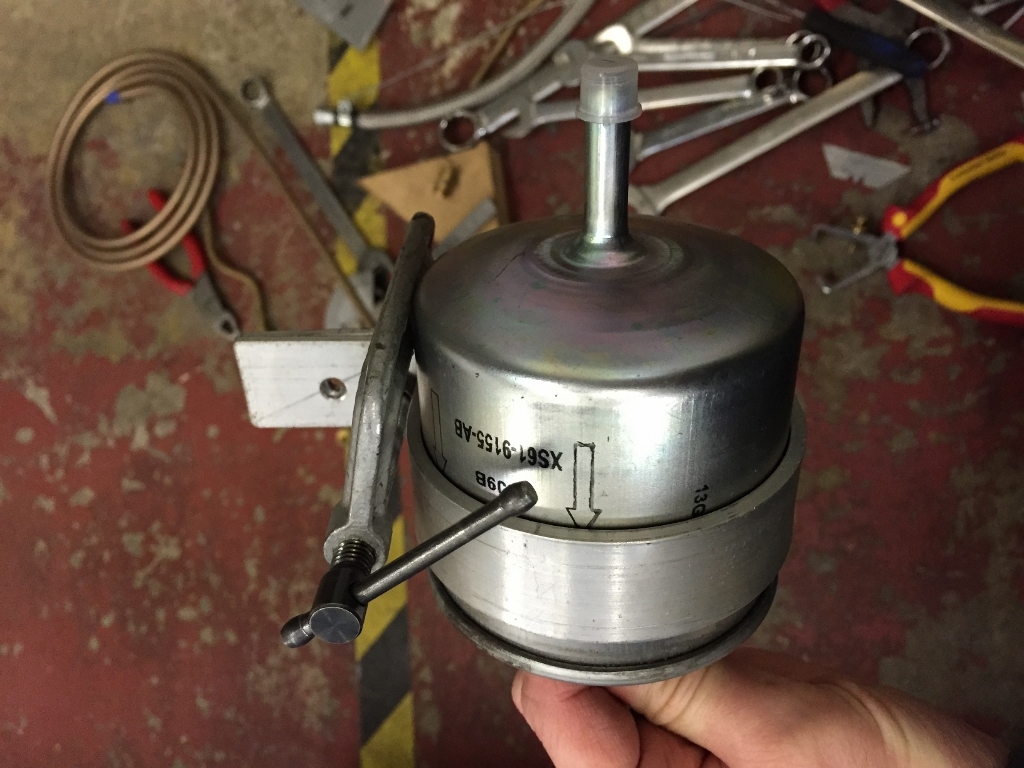

We also need to fit a high pressure fuel filter, we have a variety of units in stock - having looked at the VAG, Ford and Vauxhall units it looks like the most favourable is a Ford unit.
Down side - we need a bracket - so out with some aluminium bar to make one.

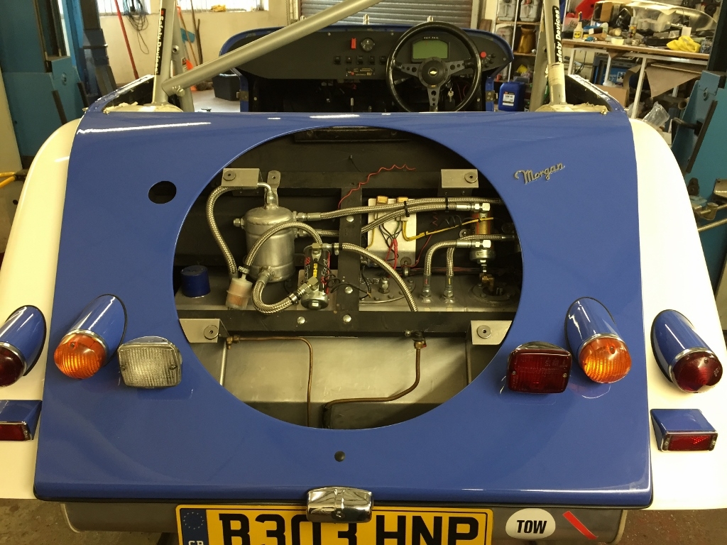

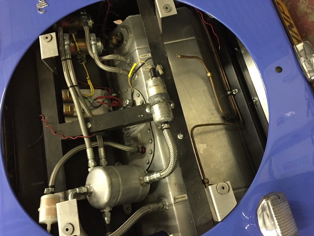

Dummied into place we get this, though we need to get the pipes made up to connect the swirl-pot and they are not open on a Sunday..
During the week we sorted out the pipes we needed and completed the install.

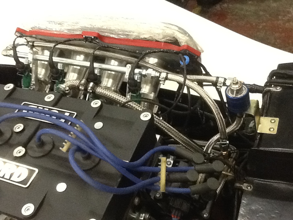

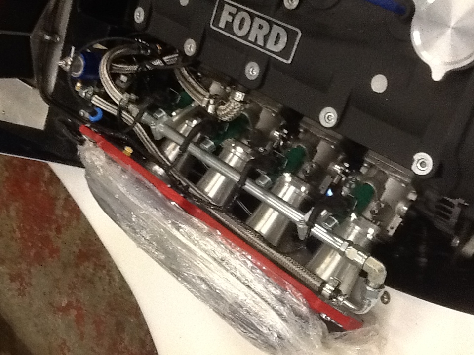

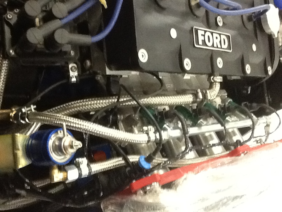

Now onto the front of the car, the feed line needs to be made up and the return needs to be connected to the weber alpha fuel pressure regulator.
The fuel pressure regulator is mounted to the bulkhead in the same place as the old low pressure fuel pressure regulator/filter combo unit.
I only have pictures of the completed job but you can see how it looks.. the other braided hose you can see is the cam breather pipe going to the Mocal oil catch tank.
